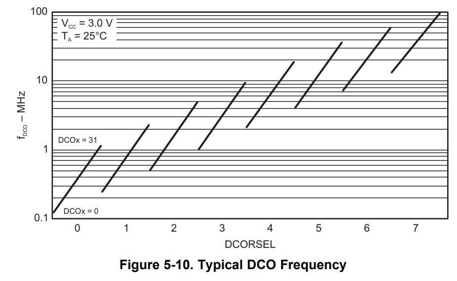

    One question I still have is about selecting the DCORSEL value; is it selected based on the final frequency for the DCOCLK or DCOCLKDIV when using the FLLD divider? In other words, for 8 MHz, for instance, DCORSEL_5 appears to be a good choice, but if I am using FLLD__8 to get the DCOCLK to 1 MHz, which is down from the DCOCLKDIV at 8 MHZ, then would DCORSEL_2 be more appropriate?

  • Hi again Mike,
    For a DCO frequency of 8MHz, setting DCORSEL equal to 2 isn't recommended because the frequency range only covers from approximately 0.5 MHz up to 5 MHz. Setting DCORSEL equal to 5 is much better for 8 MHz since the frequency range covers from 4 MHz to almost 40MHz. You can read more about these recommendations by referring to Section 5.19 (specifically Footnote #1) and Figure 5-10 in the datasheet.
    I hope this helps clear things up.
    James
  • Hi James,
    I did use the datasheet to determine what DCORSEL to use. My question was whether the choice applied to DCOCLK or DCOCLKDIV. Now I see that it applies to DCOCLK.
    Thanks so much for your help.
