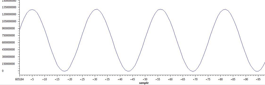

  • Thanks for your reply. In the differential mode, I am using a 1 V (P-P), 20 Hz sinusoidal signal from a signal generator as an input. The ADC result found in CCS is given below:
    This result I got when I am using 500 mV offset for the 1 V (P-P) input:-

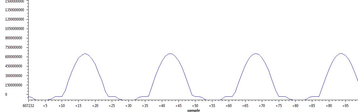

    But when I am using 0 mV offset for this 1 V (P-P) input signal, I got the following ADC result:
    Do I have to use an external offset if there is negative portion in my analog input voltage?

  • Do not apply negative voltages to the device.  You can risk damaging the part.
    The differential voltage is relative to the differential pair.  You can put the negative input to the offset voltage and then connect the positive to your input source.  Both signals, however, must be within the recommended operating conditions of the device.

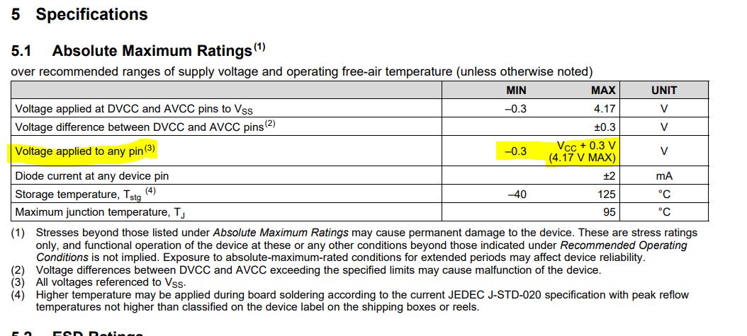

  • I am not sure what you mean, but the voltage on any pin of the chip must be from between -0.3 to Vcc + 0.3 V, relative to Vss. Basically, both voltages must be positive relative to Vss.

    Your 1st picture shows 1.3 V (P-P) , if you have applied right scaling.
    On P4.2 you have applied -0.35V out of absolute maximum ratings.
    Hope your ADC input pin has survived.
