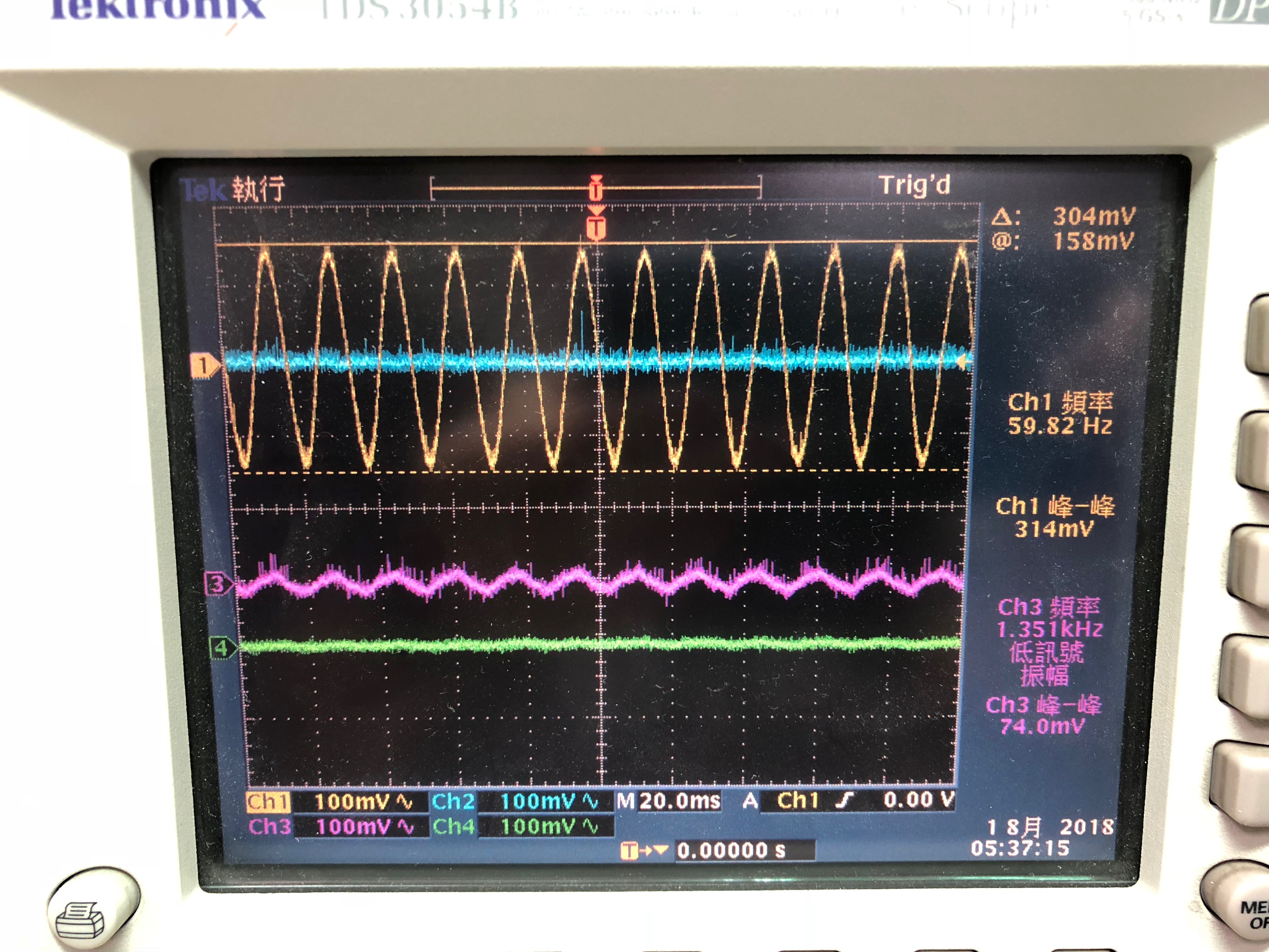

I has a Smart Plug use MSP430i2041 Has buy EVM430-I2040S 2pcs for test
but when I input 110AV output use different device about (table lamp,Electric fan)when I power on MSP430i2041 will reset I want to know protect is MSP430i2041 reset?
The figure shows the test waveform Ch1(VIN_P), Ch2(VIN_M), Ch3(IIN_P), Ch4(IIN_M)

    I'm sorry, but I'm not sure what you're asking. Are you using the EVM430-i2040S on-board power supply? Your shared scope shot seems normal. Perhaps the on-board power supply cannot supply enough power at 110VAC, which could be why the MSP430 is resetting. I suspect that raising the input to 230VAC should help. You could also disable the on-board power supply by removing the jumpers and using two AA batteries in series to supply 3.0V and use an input voltage of 110VAC.

    Thanks for sharing the video. After watching it, this doesn't seem like a reset issue but instead a power issue. Are you saying that even when supplying the EVM430-i2040S with 3.3V from a bench supply the same issue is observed? When using an external supply, make sure you remove the two jumpers that disable the on-board supply. As I mentioned earlier, sometimes I've observed this when using 110VAC or 115VAC but the issue goes away at higher AC input voltages such as 230V. With your setup, the voltage could be dropping below what the on-board power supply requires for power the EVM.
