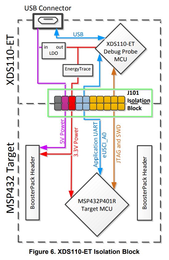

However, the problem occurred when I tried to measure power using EnergyTrace in CCSv8.2.

  • With the MSP432 Launchpad and EnergyTrace mode (not energyTrace+), remove all of the jumpers on the launchpad between the MSP and the XDS110 except for 3.3V and GND. Configure and launch EnergyTrace from CCS as described in Code Composer Studio™ IDE 7.1+ for SimpleLink™ MSP432™ Microcontrollers User's Guide.

    I removed all the jumpers except GND and 3.3V pin, and ran the program with the EnergyTrace stand-alone mode.
    There were still several problems,
    1. For timing options, "on halt" is not working.
    2. Although there was enough time for using CC3100 http post operation, I don't think CC3100 program is not properly working.
    Without several pins connecting XDS110 I can not debug the program execution. But there was no data received from MSP432.
    Using EnergyTrace with CC3100 is not possible?

  • There is no relationship between the EnergyTrace and the WIFI boosterpack. The two are independent.  In energy trace mode (simple current measure), the energy trace records the current draw of the 3.3V rail , please see figure 6 of
    http://www.ti.com/lit/ug/slau597f/slau597f.pdf
    (MSP-EXP432P401R User's Guide) .
    You can use energy trace to measure both the current consumption of the MSP432+CC3100 as long as the current does not exceed 75mA (see section 2.4.1 of user's guide).  The energytrace + mode can be used to see the states of the MSP432 only and not the device connected to the MSP432 via the boosterpack.

    Looking back at your original post, it appears that you are not viewing the states of the CPU, even if you were this would only impact your ability to enter LPM3 (deep sleep). I am concerned that because the issue appears to be related to the AP, that you are consuming too much current and the energyTrace is starving the application for current and causing the application to hang. Please consider using an alternative means of measuring the current to make sure you are within the current limits of the energyTrace tool. Based upon an analysis of the datasheet it would appear that energyTrace cannot be used because the current consumption is too high.
