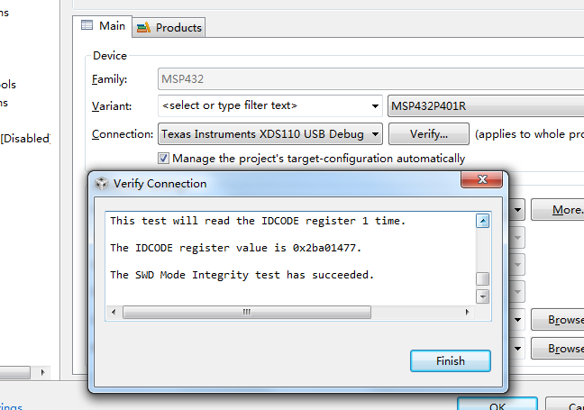

After the simulator is powered on, the development board is running normally.I can find my xds110 emulator in my ccs. Verify the information below.

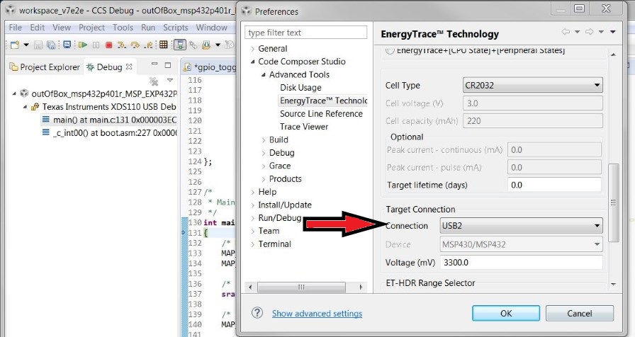

    If your external emulator did support EnergyTrace, then your preferences in CCS may not be pointing to the external XDS110. To check this, from within CCS click on Window->Preferences to get the popup window below, then select "Code Composer Studio"-> Advanced Tools-> EnergyTrace Technology and find the "Target Connection" section.
    For an external XDS110, the Connection option should say "XDS110".
    For the onboard XDS110, the Connection option should say "USBx" (where x=1,2, or 3).

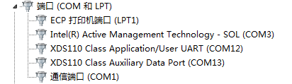

  • After my emulator is connected to my PC, it can be recognized as xds110 in my device manager .

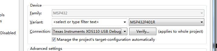

    In my CCS IDE, it can also be recognized as xds110

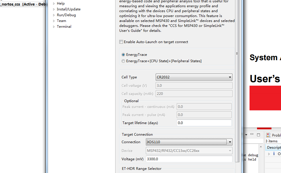

    therefore in energytrace setting I choice the connection:XDS110
    Is it possible that my xds110 emulator firmware or circuit does not support EnergyTrace?
