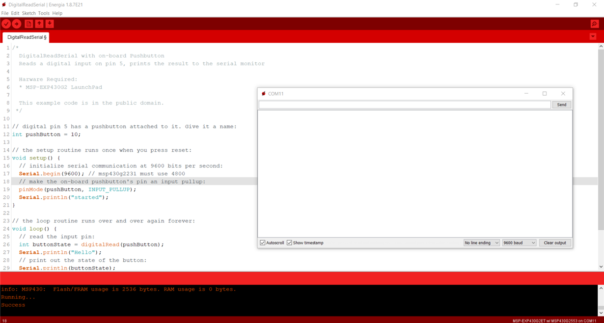

I'm trying to use MSP-EXP430G2ET with Energia 1.8.7E21. Sample programs like Blink work fine. However, when I try to use a program like DigitalReadSerial that print to Serial, nothing is getting appeared on Serial Monitor. Tried keeping the TX, RX Jumpers horizontally as well as vertically. Still didn't work.

  • Yes. The program has 9600 baud rate in Serial.begin and the same has been selected in the serial monitor.

    I checked the following,
    Kept the jumpers in the same direction as other jumpers. Same result, nothing printed on Serial monitor after reading a pin continuously.
    Rotated the jumpers by 90 deg. And tried sending characters from Serial monitor didn't get any echo.
    As you said, there are two COM ports MSP Application UART1 and MSP Debug Interface. Tried opening the serial monitor on MSP Debug Interface port (higher number). Still no result.
    I downloaded the latest version of Energia. It has the MSP-EXP430G2ET board listed.
