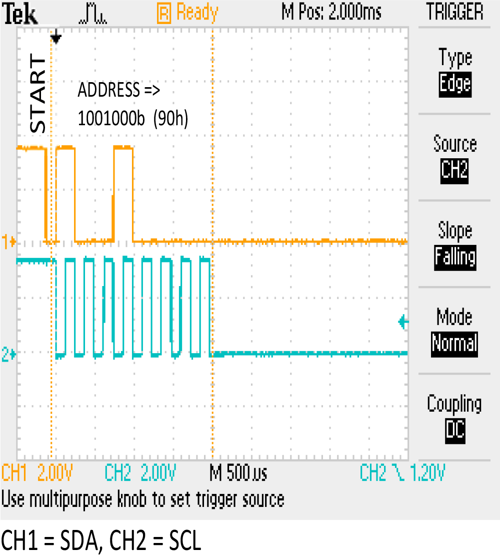

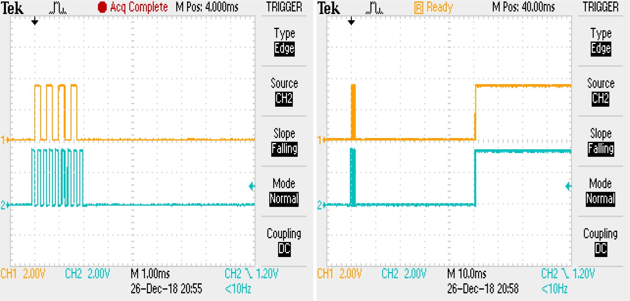

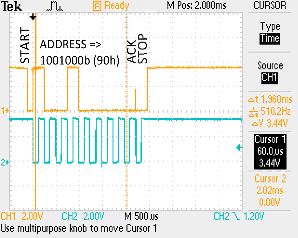

Hi, I'm trying to read the DS1621 temperature sensor on I2C using MSP430FR2433.
Batch execution of reading lines of code causes the I2C bus to “hang” and the ACK confirmation bit is not generated !!!
bis.w   #UCTXSTT, &UCB0CTLW0   ; I2C START+ADDRESS
mov.w #0x00AA, UCB0TXBUF         ; Command DS1621 (Read Temperature)
bis.w   #UCTXSTP, &UCB0CTLW0   ; I2C STOP
If I have a program in steps, then the I2C bus works!

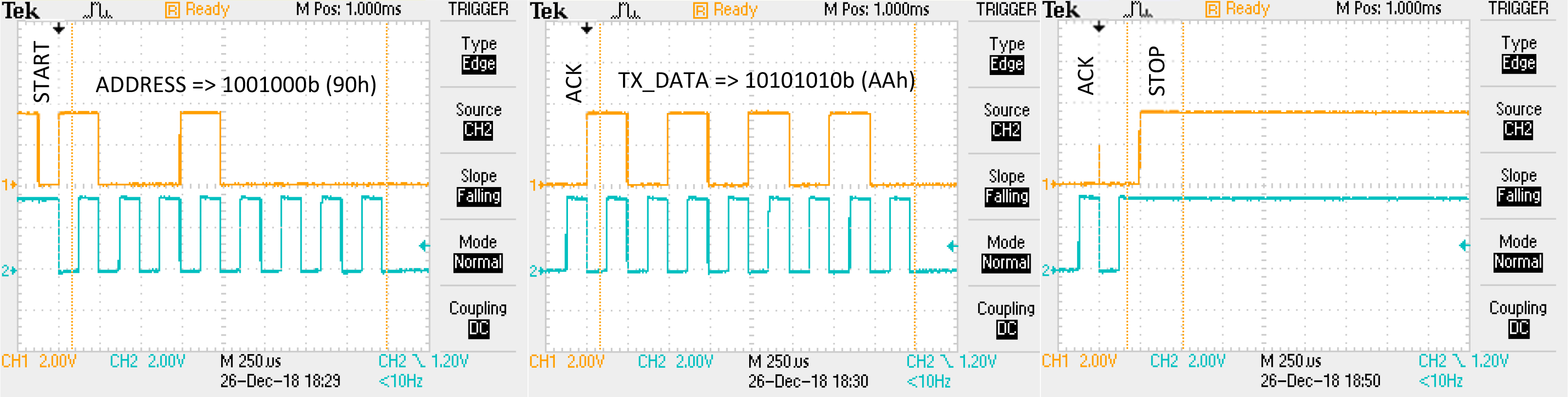

There is a “partially” write cycle of the I2C bus in 2 stages
or

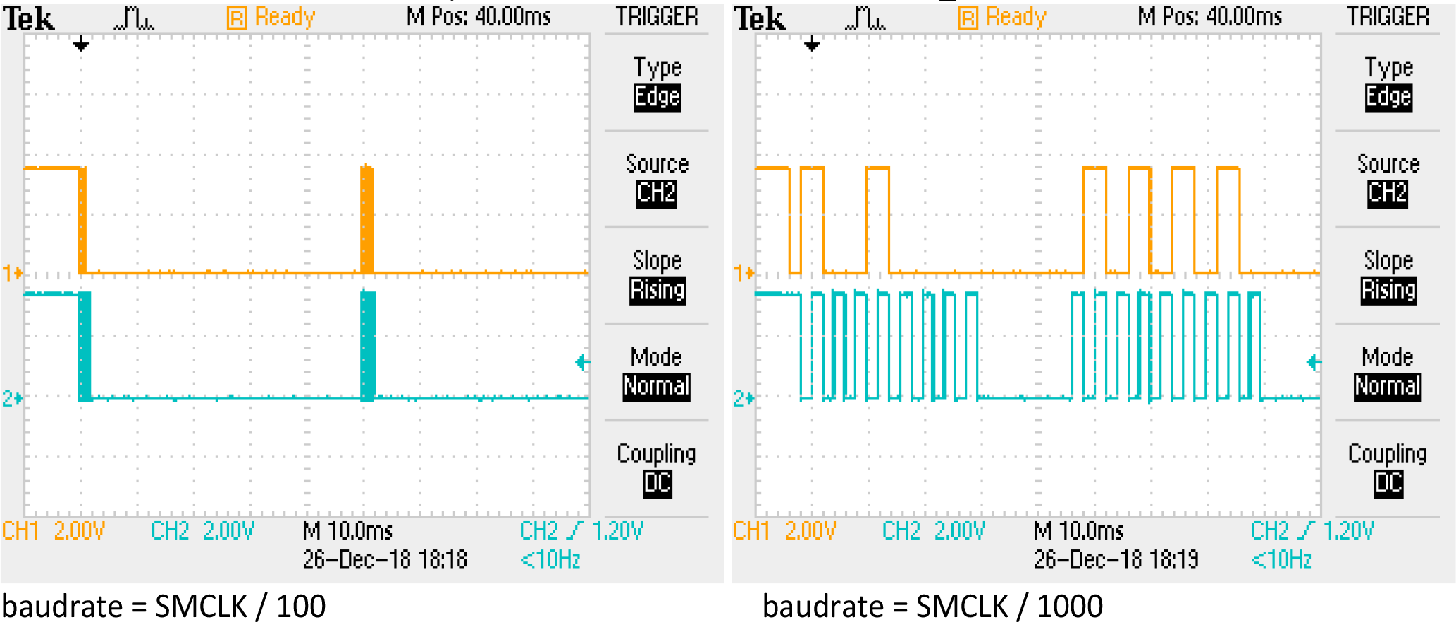

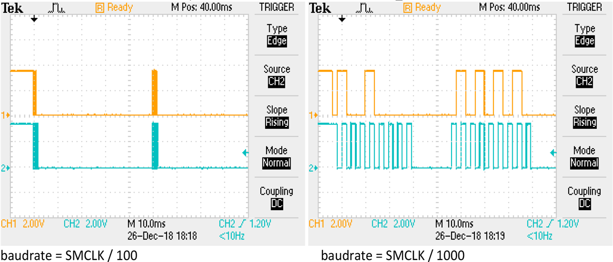

then after START + ADDRESS, ACK + TX_DATA appears in 50ms intervals regardless of baudrate.

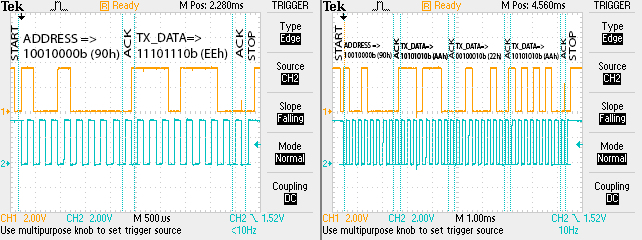

Cycle recording of several bytes on the I2C bus is not possible with a partial step by step debugging in 2 stages.
bis.w #UCTXSTT, &UCB0CTLW0 ; START+ADDRESS
mov.w #0x00AA, UCB0TXBUF ; ACK+Command DS1621 (Read Temperature)
mov.w #0x00EE, UCB0TXBUF ; ACK+Command DS1621 (Initiates temperature conversion)
mov.w #0x0022, UCB0TXBUF ; ACK+Command DS1621 (Halts temperature conversion)
bis.w #UCTXSTP, &UCB0CTLW0 ; ACK+STOP

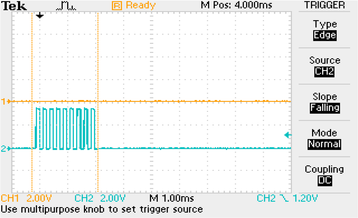

only ACK + 1 byte of data + is transmitted with the same interval of 50 ms appears on the NACK + STOP bus
If you pre-set the data in the register UCB0TXBUF and then in one command to set the bits START + STOP
bis.w #UCTXSTT+UCTXSTP, &UCB0CTLW0 ; I2C START+ADDRESS
START + ADRESS + ACK + STOP appear on the bus I2C.
  1. Why MASTER does not generate ACK after transmitting every 8 bits of data as it is supposed by the I2C protocol and forms it before transmitting the next state (TX_DATA and STOP)?
  2. Why does the I2C automaton "hang" 50 ms?
  3. Why does the I2C automaton refuse to perform the bus cycle without step-by-step mode (Analysis of the UCBBUSY bit did not lead to the result)?
  4. How to transfer several data bytes in 1 write cycle in SLAVE?

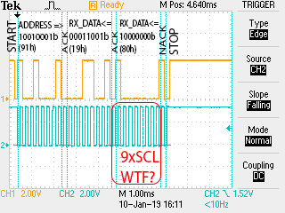

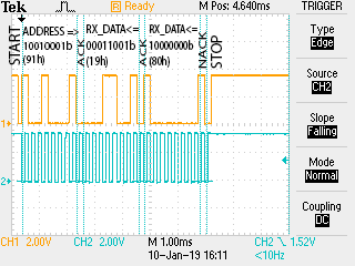

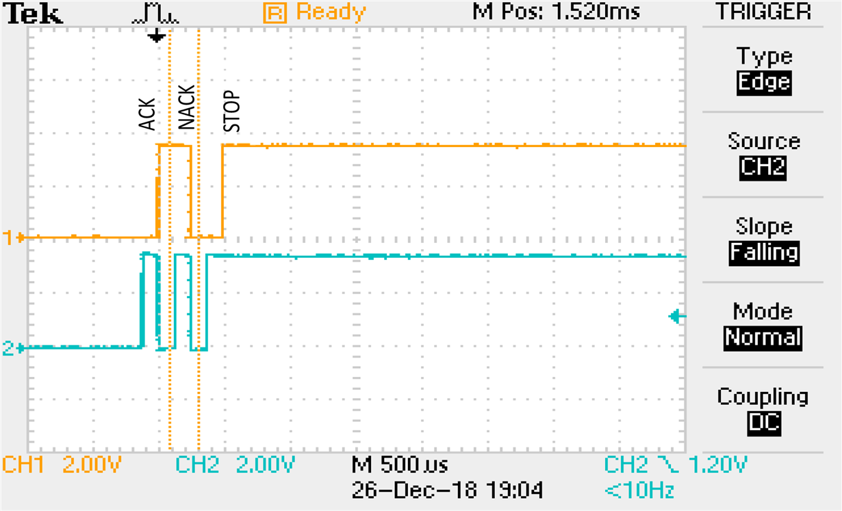

Batch code execution causes only the first byte to be read!
bis.w #UCTXSTT, &UCB0CTLW0 ; I2C START+ADDRESS+RX_DATA
mov.w UCB0RXBUF, R7
mov.w UCB0RXBUF, R8 ; ACK+NACK+STOP

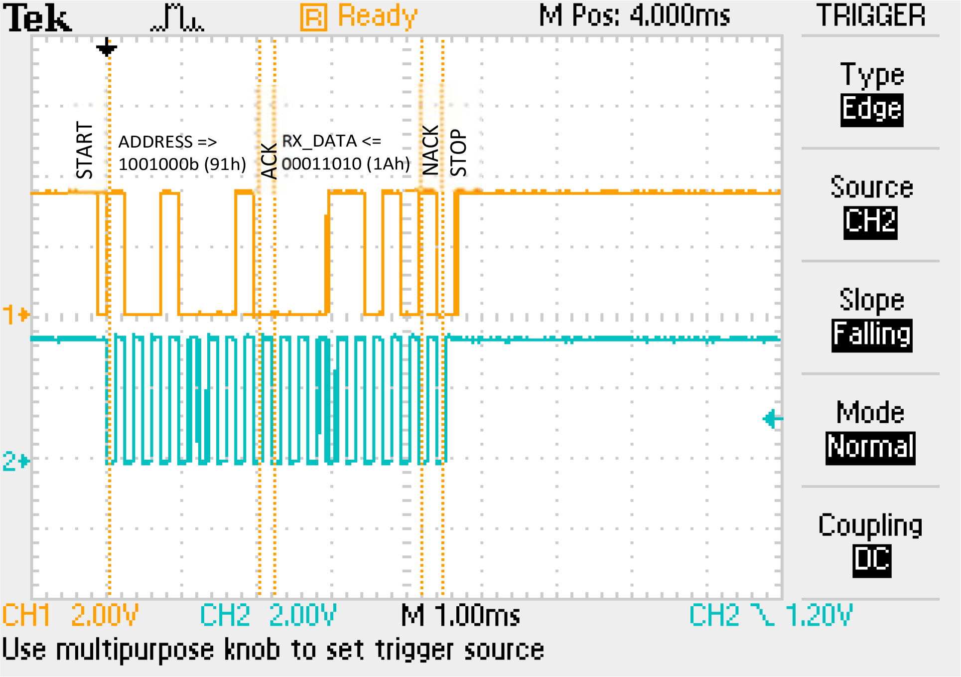

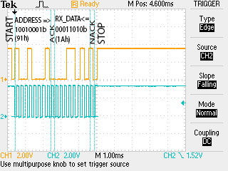

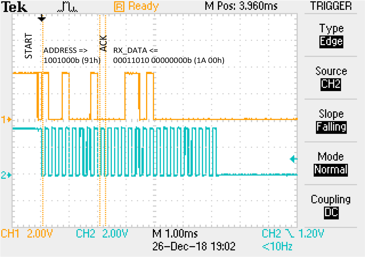

In the step-by-step execution of the
bis.w #UCTXSTT, & UCB0CTLW0
command in the debugger, it calls START + ADDRES + ACK + RX_DATA (16bit), while the UCB0RXBUF register (slau445h.pdf page 655) accepts only 8 low bits!
Read register UCB0RXBUF causes ACK + RX_DATA (8 bits) on the bus
mov.w UCB0RXBUF, R7
Read register command UCB0RXBUF when the #UCTXSTP bit is set causes ACK + NACK + STOP
bis.w #UCTXSTP, & UCB0CTLW0
mov.w UCB0RXBUF, R7                          ; ACK + NACK + STOP
Running
bis.w # UCTXSTT + UCTXSTP, & UCB0CTLW0
causes a read cycle of 8 data bits START + ADDRESS + ACK + RX_DATA + NACK + STOP
How to read a few bytes of data?

  • > bis.w #UCTXSTT, &UCB0CTLW0 ; START+ADDRESS
    You need to wait for UCB0IFG:UCTXIFG to go high before writing to UCB0TXBUF. Doing it earlier causes the byte to be discarded. [Ref User Guide (SLAU445H) Fig 24-12.] Then when the SLA byte is complete, the MSP430 holds SCL low waiting for you to load the TXBUF.

    Working ASM code samples are written to the I2C bus:

    Writing to the  I2C bus - OK! RESOLVED
    How to read the I2C bus?
  • Set UCTR=0 and then set UCTXSTT. Each time UCRXIFG goes high, fetch a byte from UCB0RXBUF. With STP=2 the device will issue the Stop for you after TBCNT bytes. (Incidentally, I don't see you setting UCTR=1 above, but the scope trace claims you did. Is something missing?)
    For e.g. the Read Temperature (0xAA) sequence above, instead of issuing the UCTXSTP, just set UCTR=0 and set UCTXSTT right then. This will get you a Repeated Start, which the DS1621 data sheet says is just fine.
  • Hi Bruce: Thanks for your support on this thread.
  • // READ I2C (2 BYTE)

    // READ I2C (1 BYTE)
           bic.w #UCTR, &UCB0CTLW0
    rd3 bit.w #UCRXIFG0, &UCB0IFG
          jnc rd3
          mov.w UCB0RXBUF, R7
    Why are 9 additional SCL cycles inserted?
    How to get rid of them?
  • Short answer: Move the UCTXSTP setting up one line, to precede reading UCB0RXBUF.
    As soon as you read RXBUF, the I2C unit will proceed with fetching the next byte, including ACKing the byte you just read. So you need to set TXSTP before reading the RXBUF for the last byte. [Ref UG (SLAU445H) sec. 24.3.5.2.2, paragraph 6].
    The Example msp43fr231x_eusci_i2c_standard_master.c illustrates this, though it issues the stop even earlier. (I don't see this Example in the FR2433 Example suite, I don't know why.)
  • // READ I2C - 1 Byte
          bic.w #UCTR, &UCB0CTLW0           ; I2C=RX
    rd1 bit.w #UCRXIFG0, &UCB0IFG
          jnc rd1
          mov.w UCB0RXBUF, R7
    R7 = 0019h and not 8019h (OK!)
    but UCB0RXBUF = 0080h!!!
    How to make sure that the second byte is not read?
    Sample 5 - Recive 2 bytes to I2C bus (No automatic STOP generation)-----------------------------------------------------------------------------------------
    Reading two bytes - works!
          jnc rd1
          mov.w UCB0RXBUF, R7
    rd2 bit.w #UCRXIFG0, &UCB0IFG
          jnc rd2
          mov.w UCB0RXBUF, R8
    R7 = 0019h  R8 = 0080h
    Sample 6 - Recive 1 bytes to I2C bus (No automatic STOP generation)-----------------------------------------------------------------------------------------
          bis.w #UCTXSTT+UCTXSTP, &UCB0CTLW0 ; I2C START+STOP
          jnc rd1
          mov.w UCB0RXBUF, R7
    R7=001Ah
    The recive of 8 data bits works only when START + STOP in one command. It is correct?
  • I don't know the answer. This doesn't appear to match the behavior described in that paragraph. (Maybe there's a footnote someplace.) I usually use TBCNT with UCASTP=2, so the hardware does all this for me.
    As a practical matter, reading the extra byte requests a little extra (unneeded) work from the sensor, but I don't see a case in the DS where it will cause incorrect results. You would not see 0119h (or 8019h) in RXBUF in any case, since the high bits there are always 0.
  • Thanks!
    I apologize. I made a typo. R7 = 8019h (Corrected my question above)
    As I understand, Receive data of 8-bit data only when START + STOP in one command.
    If STOP is not in the same command line, then the device reads 2 bytes!
    It is correct?
