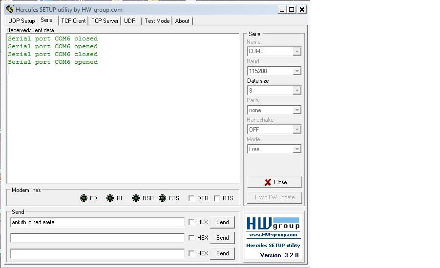

Hi Gary,

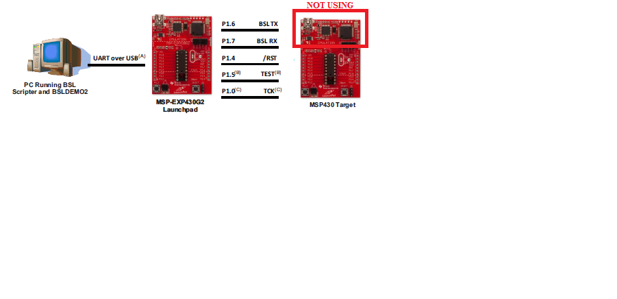

Thanks a lot for your support. To answer your question,we are NOT using BSL rocket for programming. We are using the flow described in the document - "slaa535a" which uses MSP430 launch pad for BSL programming.
In order to ensure that there is no issue with our example code, we have used the traditional approach of progamming the IC within the launch pad board using CCS. We confirm that our code works and as you can see below, there is communication betwen the IC and Hyperterminal. However, if we attempt to flash the same code using BSL, we run into issues specific to UART/USCI functionality. Once we flash the chip using BSL, it fails to communicate with hyper terminal even after attempting to reflash the same with CCS again. In other words, we can never get the IC to communicate over its hardware UART ever.
1) If we program a new MSP430G2553 chip with CCS, we are able to communicate b/w the IC and Hypterminal. Please see below for reference
2) Now we have tried to program this IC with the same code (after dumping the corresponding .TXT file) using MSP430 BSL flow as described in slaa535a. This runs successfully but the IC fails to communicate with Hyperterminal as shown below
3)Please find the hardware setup details shared below. Kindly note that using this flow, we are able to successfully program any msp430 example code that does not use UART/USCI functionality. The issue arises only when this flow is attempting to flash a program that uses hardware UART/USCI functionality only. I hope this explains the issue better. Please advise if you need any further details.
Ankith
