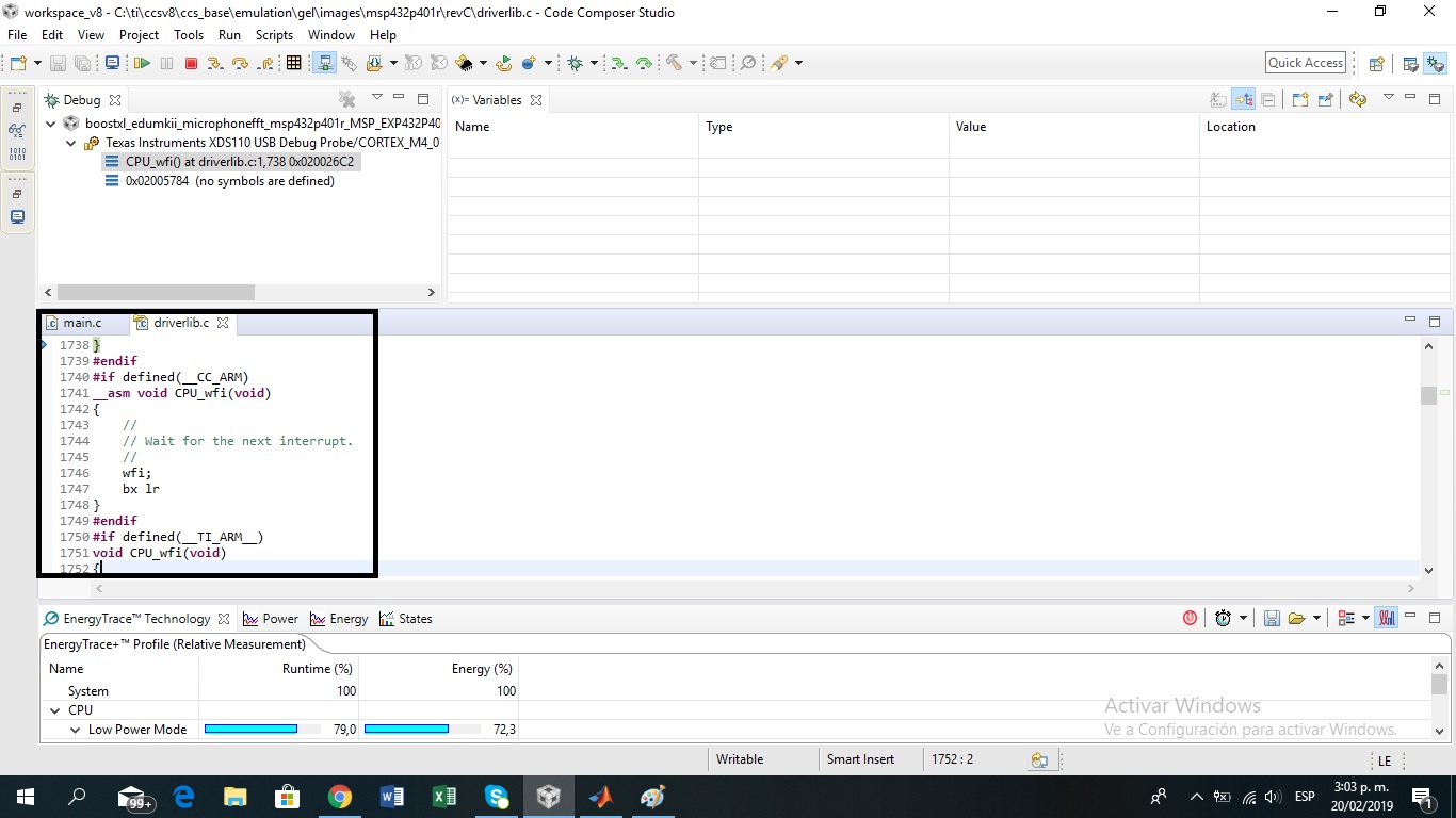

Hello!,
I am working with the MSP432 to collect data from an accelerometer through the DMA and send it through serial (UART) to my PC. It has been working well so far, until I added the EUSCI interrupt so that the MSP432 could read a byte sent from my PC. Since that moment, I cant read anything from the serial port at my PC and when I debug the code I have notice that after entering the EUSCI interrupt (when a byte is sent from my PC) the DMA interrupt stops working and there is no refreashing of data to buffer_1 and buffer_2 (refer to the code).
I am attaching the code below.

  • Hi Chris,
    Thanks for the reply!
    So, everything was working fine before I added the UART interrupt rutine to read a serial byte sent from my PC. At the begining The DMA interrupt works for a period of time and then after the UART interrupt it just stops working. Also, it shows me to a piece of code from the driverlib (picture).
    What do you mean by overwriting the TX buffer? Right now I am getting non coherent values at my PC serial port.
    This is my code so far:

    Consider the flow of your code.  The LPM0 is intended to keep the CPU from proceeding until the DMA interrupt.  Now that you have added another interrupt for the UART, this will also allow the CPU to proceed.  You may have a potential issue where the main loop is being executed while the DMA is still writing to the data.  Can you simply remove the UART ISR and within the DMA isr check if the UART received any data?  Do you really want the data transmitted continuously or do you want a burst (2Kb) of data every time a specific uart value is received.
    Not sure is the attached is helpful, but in this example instead of a UART rx a port isr is used to burst out data.
    Chris
