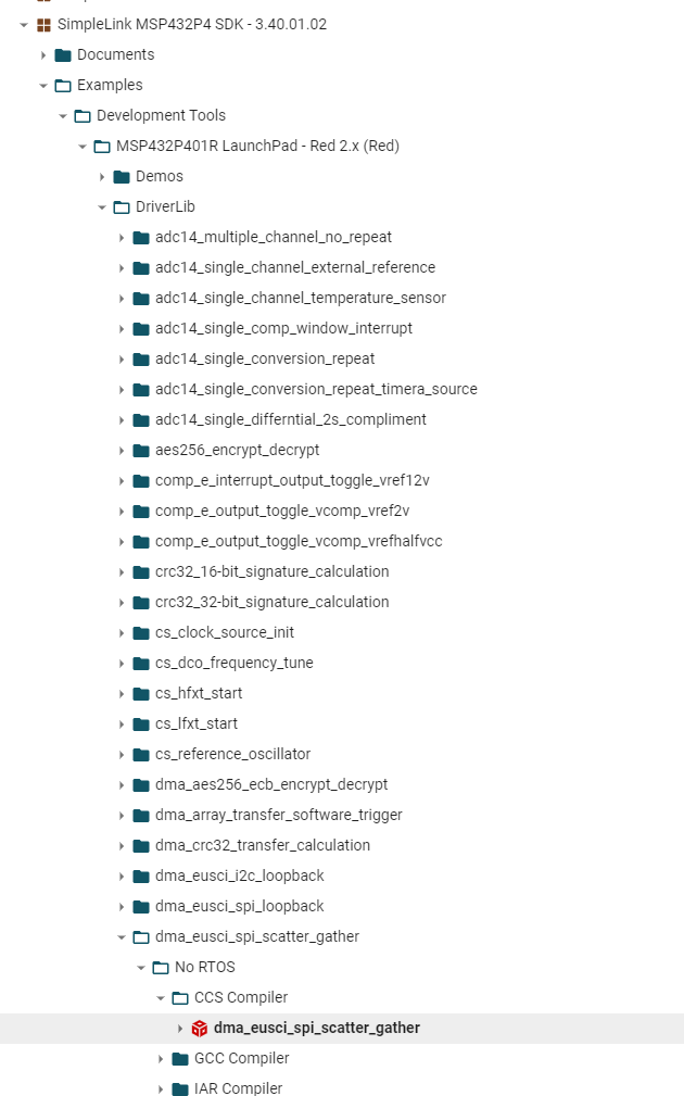

  • Hi, Jeremy,
    I have found a scatter-gather DMA code example for your reference. It is in released MSP432 driver library code examples:
    http://dev.ti.com/tirex/explore/node?node=ANZORZtHqB-z5DGdUK2Ryg__z-lQYNj__LATEST
    Please try it and let me know if you have any further questions.
    Lixin

  • Hi, Jeremy,
    Thanks for the information. We will check this. Any way, you can try the code example I sent to you. Its last configuration is 'basic'. You can check if it works for the interrupt trigger and if there is any difference from your code.
    Lixin
