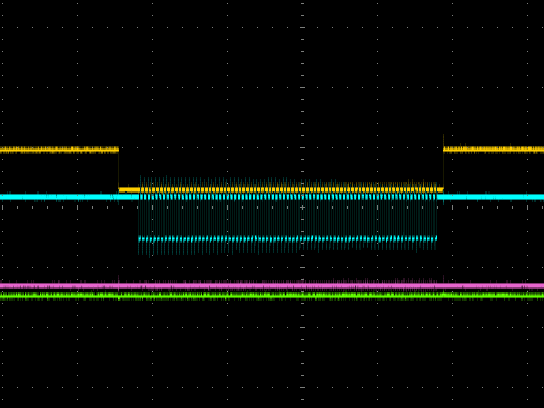

Spi peripheral works perfectly fine, reading and writing sensor settings at startup. The problem arises when I try fetching external FIFO contents via the DMA: MOSI and MISO do not move, and counting SCK pulses on the oscilloscope I see barely 10 byte transfer attempts. DMA_INT1 triggers properly, apparently too early. I suspect that something is wrong with triggers, and some tasks simply overlap, but I can't see why right now.
Any clues?

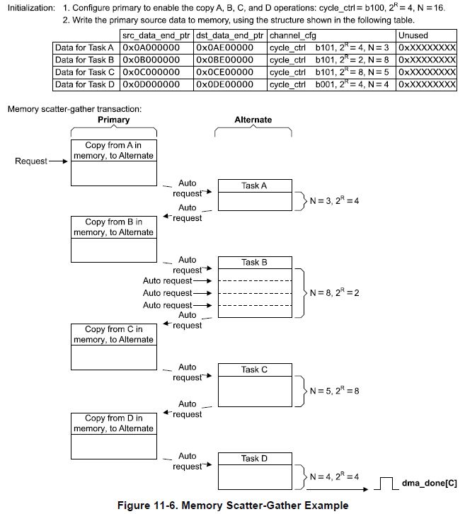

  • Giovanni,
    Can you explain how you expect the tasks in the scatter-gather to be triggered and why you are using the software transfer API? One of the challenges with the the scatter-gather is that you are only allowed one external trigger. Your tasks can either be triggered automatically (once the previous task is completed) or manually from the one external trigger selected. In your code it looks like you are trying to use the sotware trigger, the RX trigger, and the auto-trigger.
    Since you are configuring the manual trigger to be the RX ifg, you would need to manually set the RX ifg to start the sequence of scatter-gather tasks. Let me look and see if I can find an example.
    Chris
  • Hello Chris,
    let me check if I grasped the concept behind the scatter-gather triggering thing:
    • When a DMA channel is associated to a peripheral in scatter-gather mode it gets triggered as usual, if the corresponding interrupt flag goes high.
    • Selecting '0' as isPeriphSG argument for DMA_setChannelScatterGather function we declare that channel alternate data structure has to be updated with next task automatically, with no need for a trigger.
    • Tasks can be of MEM_SCATTER_GATHER kind, being executed as soon as they are loaded into the alternate data structure, or PER_SCATTER_GATHER kind, that wait until the channel-associated interrupt flag is high.
    • In the SPI readout case the best option is to set dummy-byte transmission task trigger as automatic (MEM) and use SPI_RECEIVE_INTERRUPT_FLAG for triggering byte fetching tasks (PER).
    What's the limit for the tasks list length?
    Looking at the trace I posted, it is clear that the software trigger actually triggers something (SCLK runs for quite long and DMA ISR is entered). I went for software trigger because I was unable to see whatsoever effect by manually driving the interrupt flag, and that's the typical way to start an AUTO mode memory-to-memory DMA transfer, as tasks loading is. I reorganized the tasklist and corrected the code according to the four points above, yet I still can't retrieve data, and the data transfer does not even seem to start.
    Let's recap what I am trying to do, I must have done some silly mistake that keeps hiding in plain light.

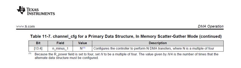

  • I think you have accurately described the scatter-gather triggering.  I find it helpful to also look at the diagrams in the TRM.
    The limit for the number of tasks is 256. This means that the primary is actually set to 1024, performing 4 transfers (from task list to the alternate data structure) 256 times.
    In the Table/Channel assignment you have selected DMA_CH5_EUSCIB1RX1. This is an invalid SPI channel. RX1/TX1,RX2/TX2, and RX3/TX3 only apply to the I2C slave addresses UCBxI2COA1, UCBxI2COA2, and UCBxI2COA3. For UART and SPI only the RX0/TX0 are applicable.
    Hope that helps,
    Chris
