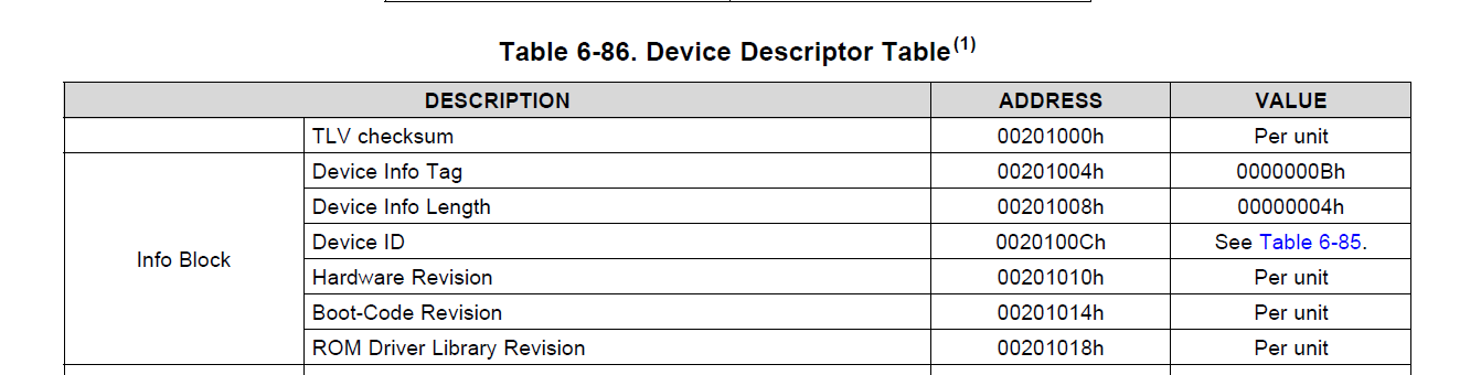

  • What is the revision of the silicon (B,C,D?) and BSL that resides in information memory?
    Chris
