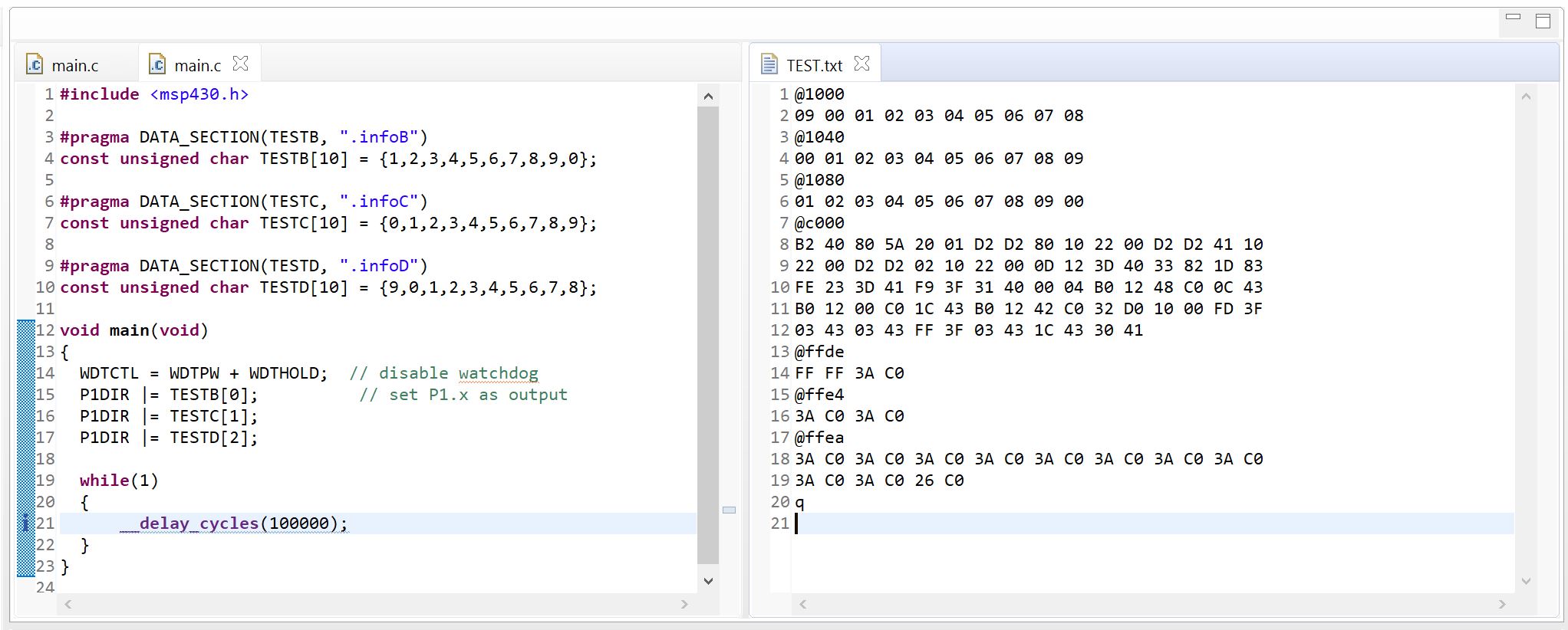

  • Nitish,
    I just run a quick test on my PC, and no issue was found. Would you please try the code below?
    #include <msp430.h>
    #pragma DATA_SECTION(TESTB, ".infoB")
    const unsigned char TESTB[10] = {1,2,3,4,5,6,7,8,9,0};
    #pragma DATA_SECTION(TESTC, ".infoC")
    const unsigned char TESTC[10] = {0,1,2,3,4,5,6,7,8,9};
    #pragma DATA_SECTION(TESTD, ".infoD")
    const unsigned char TESTD[10] = {9,0,1,2,3,4,5,6,7,8};
    void main(void)
      WDTCTL = WDTPW + WDTHOLD;  // disable watchdog
      P1DIR |= TESTB[0];          // set P1.x as output
      P1DIR |= TESTC[1];
      P1DIR |= TESTD[2];
      while(1)
          __delay_cycles(100000);
    Ling
