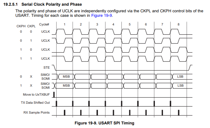

    Below code of SPI connection (GPIO expander) is what's problem? and also below code UART jumper requier or not ? do not have any LED blink.
    Code:

    I am using MSP430 2553 with the connection of GPIO expander with SPI connection. In the GPIO expander port, I have to connect LED but they have not started so above code work fine in this condition or any mistake on that code? and also In this communication require a UART jumper or not?
  • Hi Yash,
    Ok, from what I can tell, your code should work.
    No UART jumper required.
    If the GPIO expander is not working, it is possible that the SPI clock phase and polarity configured on the MSP430 does not match the GPIO expander requirements.  You will need to check GPIO datasheet.
    Here is an description from the MSP430x2xx users guide.
  • Thanks for your great support currently some board issue I will not able to check but again Thanks
    Thanks for support my problem resolved finally.your right clk selection.
