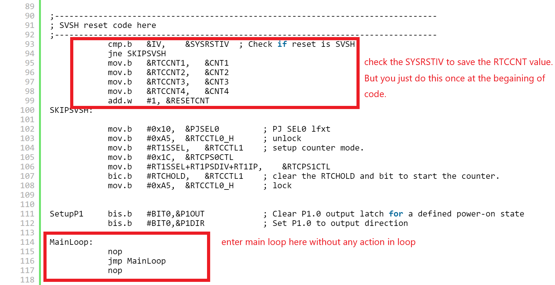

; SVSH reset code here
			cmp.b 	&IV,	&SYSRSTIV  ; Check if reset is SVSH
  			jne SKIPSVSH
  			mov.b 	&RTCCNT1,	&CNT1
  			mov.b 	&RTCCNT2,	&CNT2
  			mov.b 	&RTCCNT3,	&CNT3
  			mov.b 	&RTCCNT4,	&CNT4
  			add.w	#1,	&RESETCNT
SKIPSVSH:
            mov.b   #0x10,	&PJSEL0			; PJ SEL0 lfxt
  			mov.b	#0xA5,	&RTCCTL0_H		; unlock
  			mov.b	#RT1SSEL,	&RTCCTL1	; setup counter mode.
			mov.b	#0x1C,  &RTCPS0CTL
			mov.b	#RT1SSEL+RT1PSDIV+RT1IP,	&RTCPS1CTL
			bic.b	#RTCHOLD,	&RTCCTL1	; clear the RTCHOLD and bit to start the counter.

    After reviewing you code, I'm confused the time you read and save the RTCCNTx. You read and save the RTC count values after the SVSHIFG SVSH event (BOR). However, the RTC count registers shouldn't contain the value after a BOR, which mean the count values would be reset or some dummy value after a BOR reset.
    I will double confirm with our development team for the value of the RCTCNTx after a BOR event.
  • I read the RCTCNTx after the SVSH event but before the BOR.
    The issue is if the supercap discharges, everything can be kept running until the SVSH event. Now the RCTCNTs are saved to FRAM to be restored when a normal power-up happens. (I can confirm that the save does happen before the BOR.)
    I'm confused with your assembly code. You just check the SYSRSTIV and do the saving at beginning of your code, which could just be run after a new power up or PUC/BOR reset. However, all these events could let RTCCNTx not containing the value.

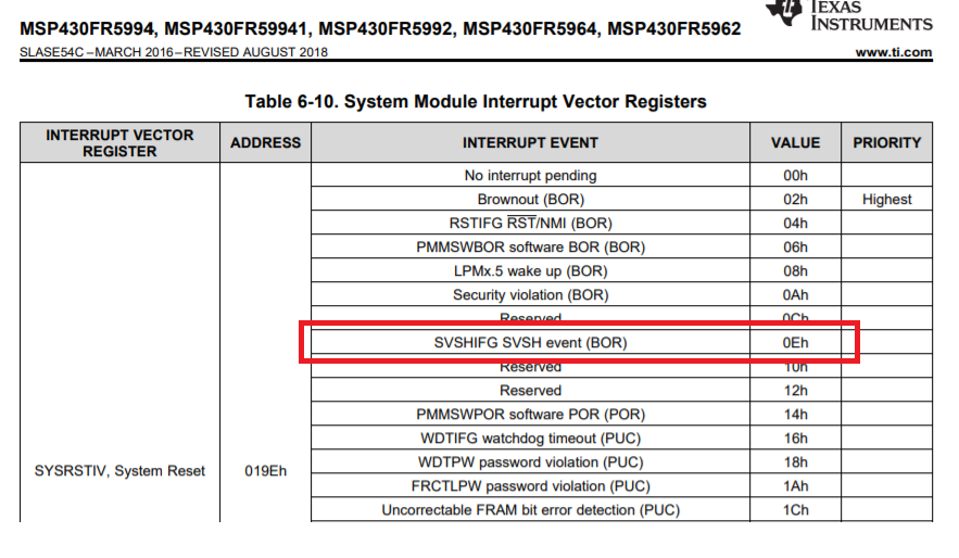

    I would make it clear for your code of reading and saving the RTCCNTx value. These codes were run after checking the SYSRSTIV with SVSHIFG SVSH event (BOR) condition(0Eh)
    Please be noted that the SVSH event will trigger a BOR reset, which means the 1&2 reset conditions from your last reply are actually the same one. You can find the detailed description on section "1.2 System Reset and Initialization" and "2.2.2.1 SVS Thresholds" of the device User's Guide.

    You may need to refer to section "1.2 System Reset and Initialization" of the device User's Guide. The device has 3 types of system reset, which are a brownout reset (BOR), a power-on reset(POR), and a power-up clear (PUC). And an SVSH low condition will trigger a BOR. I can't find any description for an individual SVSH reset in the User's Guide. If you could find any information, please share me.
