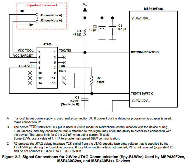

We have recently purchased a MSP-FET Flash Emulation Tool from mouser. When I was trying to connect to MSP430F4132 through MSP-FET debugger with 4 wire JTAG connection(FET-Pro430 lite), it shows below error:
JTAG communication initialization.... failed
Verifying Security Fuse .................... failed
--------------- FAILED !!! -----------------
When I tried to execute "Verify Security fuse" command it shows below error:
Target Microcontroller is not responding!!!
Please check the connection between the adapter and target microcontroller.
So I have also tried to download and debug from IAR workbench, there also no success and shows below error:
Thu Apr 04, 2019 15:31:12: IAR Embedded Workbench 7.12.1 (C:\Program Files (x86)\IAR Systems\Embedded Workbench 8.0\430\bin\430proc.dll)
Thu Apr 04, 2019 15:31:14: Using license: PC-locked license - IAR Embedded Workbench for Texas Instruments MSP430, 8K KickStart Edition 7.12
Thu Apr 04, 2019 15:31:17: Firmware version 3.12.0.0
Thu Apr 04, 2019 15:31:17: Interface dll version 3.13.0.1
Thu Apr 04, 2019 15:31:21: Unknown device : (OpenDevice) , Device=MSP430F4132, PwLength=0
Thu Apr 04, 2019 15:31:24: Fatal error: Could not find device (or device not supported) Session aborted!
Thu Apr 04, 2019 15:31:24: IAR Embedded Workbench 7.12.1 (C:\Program Files (x86)\IAR Systems\Embedded Workbench 8.0\430\bin\430proc.dll)
Connection for JTAG 4 wire is as shown below:
Serial No’s
14-Pin Connector(MSP-FET connector)
10-Pin Connector(MSP430 JTAG connector)
1.
Pin 1 (TDO/TDI)
Pin 1
2.
Pin 3 (TDI/VPP)
Pin 3
3.
Pin 5 (TMS)
Pin 5
4.
Pin 7 (TCK)
Pin 7
5.
Pin 9 (GND)
Pin 9
6.
Pin 11 (RST)
Pin 8 (RST/NMI/SBWTDIO)
7.
Pin 4 (VCC Target)
Pin 4
8.
Pin 8 (Test / VPP)
Pin 6 (TEST/SBWTCLK)
Let me know where I am going wrong or how to establish a connection with MSP430F4132 through JTAG 4 wire/2 wire?
  • Hi Aanchal,
    I don't know what you mean with the 10-pin JTAG connector, but can you confirm the connections to MSP430 are as shown below:
    Is it possible for you to test SBW mode? Note that the connection is as shown below:
    Finally, are you using your own board or a TI board (if so, which one)?
    Have you tried using the MSP-FET with other boards/devices?
    Is your MSP-FET updated with the latest drivers?
