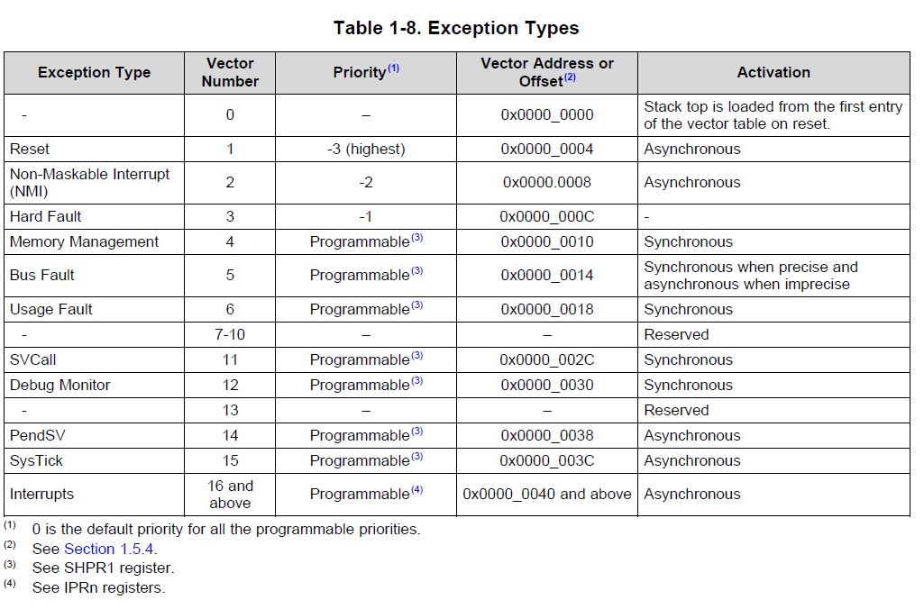

  • It looks like you are trying to write to flash address 0x0.  Please note that at this location the stack pointer and the interrupt vector table are loaded.
    Chris
  • Hi Chris,
    oh that's not good, but how can I address the main flash at 0x0?
    As far as I can understand, the whole main memory is for the user and not used by the system.
  • Ok, the vector table is from 0x0...0x268. Are there any more addresses that are used by the system?

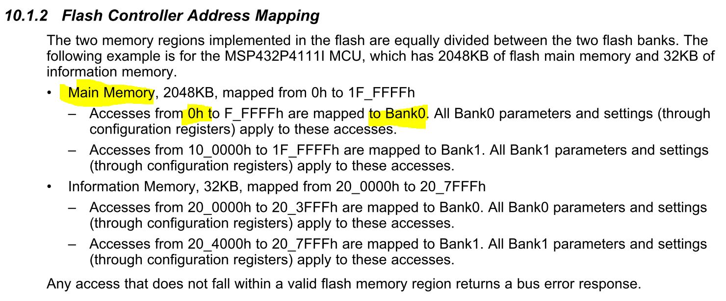

  • Ok, why the values after restart are gone I found: "Erase-Configuration" in "Debug-Configuration->MSP432_Settings":
    I switched from "Erase main memory only" to "Do not erase Flash memory".
    But which addresses are used by the system, e.g. vector table from 0x0...0x268?
    I think there are more than only the vector table, because I read at 0x1 0000 not a value like 255 (see reading above).
    when I restart a debug session with ccs after I switched the "Erase-Configuration" in "Debug-Configuration->MSP432_Settings" from "Erase main memory only" to "Do not erase Flash memory" then ccs ends up in different "errors" at beginning of the code. The only way I can recover this is to switch back to "Erase main memory only". But then the programmed values are gone...
    So I'm asking me is this the right way to prevent ccs for delete the memory?
  • If you want to reflash the application code but leave the space that you have written to, then you can either use the 'Erase and download necessary segments only' or in the linker command file you can create a section to which the IDE does not write to.  Additionally, in CCS you can launch a target configuration and connect to the device and look at the memory content without actually downloading any code and running the debugger.

  • Hi Chris,
    Ok I found the memory browser and I also found out how to connect without debugging, great!
    But how can I prevent the ccs to erase e.g. bank 1 from main memory (0x10 000...0x1F FFFF) ?

  • Thank you Chris for answering.
    I reduced the range of the main flash to ony bank 0:
        MAIN       (RX) : origin = 0x00000000, length = 0x000FFFFF
    But after restart debugging, the written values beginning from 0x10 0000 are all erased (FF).
    Normally it shouldn't erase the not declared range bank1 0x10 000.... (even with the setup is "Erase main memory only").
    What's going wrong?
  • I believe that you project settings are configured to erase main memory on debug.  I would recommend changing so that it is only the necessary segments are erased.
    Chris
    'Erase and download necessary segments only': what is the meaning with necessary segments?
    'Erase main memory only': I thougt, that if I set the main flash with
    then bank1 will not be erased regardless of whether 'Erase main memory only' or 'Erase and download necessary segments only'.
  • The Flash memory can only be written as '0'. You cannot write a '1'. Therefore in order to program memory you must first erase, set all bits to '1' before you can program, set bits to '0'. A mass erase is much faster but it erases everything. You can selectively tell the IDE to only erase the sections which need to be programmed.
    The linker definition of MAIN only tells the IDE which locations to program. Which locations are to be erase can be controlled independently from the IDE. You must make sure not to 'program' the same location twice without first erasing.
    Chris
