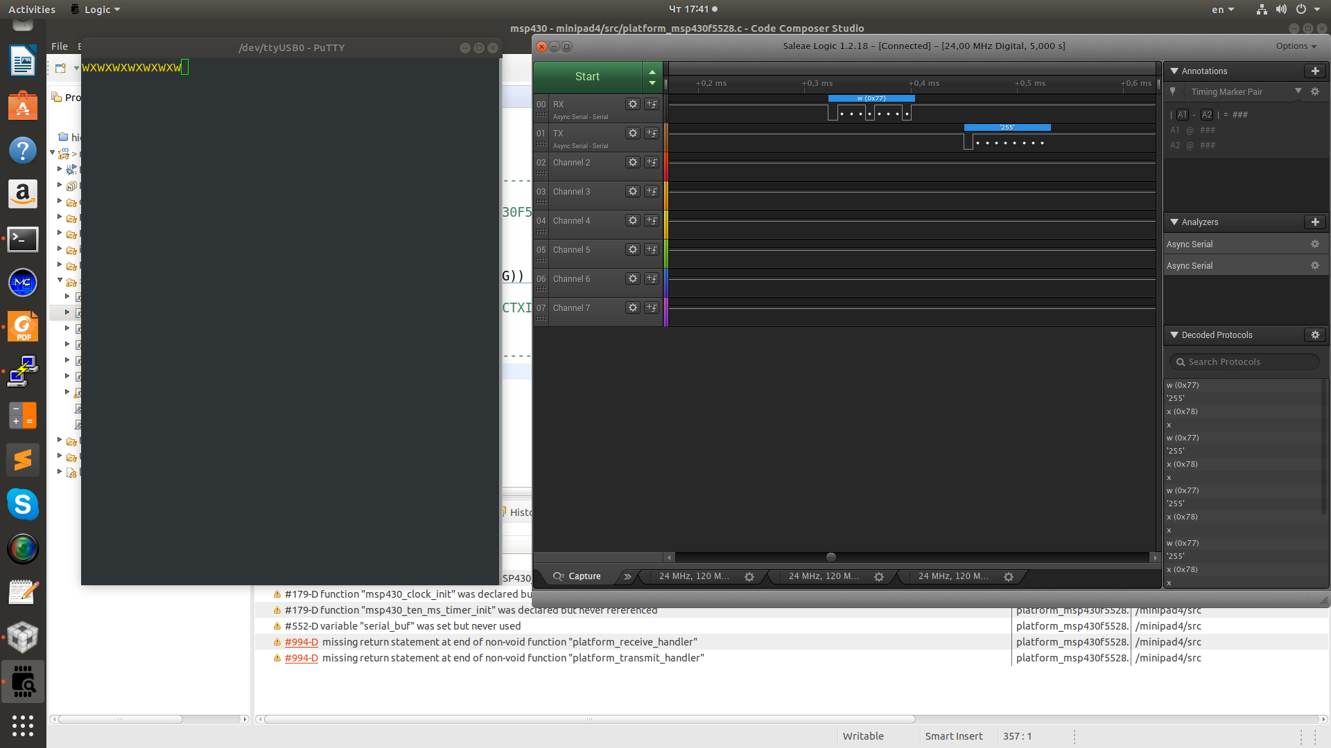

I ask for help in solving the following problem: I submit characters from the terminal program (PuTTY) to the input of the UART receiver, in the RX interrupt I put the received symbol to the transmit buffer, but I cannot correctly receive more than half of the ASCII table symbols, instead of the symbol I receive 0xFF. I see correct test message after UART initiated, so I suspect that TX part works well. The second problem is that UART starts transmitting the symbol without waiting for the reception to end. Code and screenshots of the logic analyzer are attached.

    Here it is something else. I did not quite correctly describe the problem - the digits and symbols 'a' to 'd' and 'n' to 'w' are taken incorrectly, both the lower or the upper case, this can be seen on the screenshots where is the reception of two adjacent symbols. I do not use national symbols, so 7 bit or 8 bit format doesn't matter.I suspect that using the DriverLib API will not solve this problem.

  • These are the symptoms of a questionable clock. First guess is that SMCLK isn't quite 4MHz (within 3%). Try:
    1) putting SMCLK out on P2.2 and measuring it with your scope
    and/or
    2) posting your clock initialization code
  • Bruce, thank you very much for the hint, I checked the frequency of the SMCLK and it was twice as high as the frequency of quartz (using it on XT2). So I changed the initialization constants of the UARTs and got rid of the problem. I'm newbie with MSP430,so maybe I'm forgot to init clocks properly.
