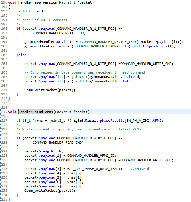

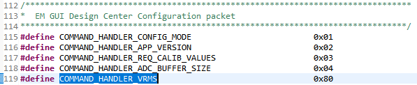

This example shows how to add a command to send VRMS. Note that I used command 0x02 (application version) as a starting point:
1. Create a function prototype in emDCCommandHandlers.c
3. Define the new command ID in emDCCommandHandlers.h (note that my "new command' is the same as COMMAND_HANDLER_VRMS_ID which is the response sent from the device, but I'm adding it as a new definition in case you want to customize it)
4. Write the new function in emDCCommandHandlers.c (note that my function just ignores when the Master tries to "write", and it sends the latest value of VRMS when the Master tries to "read")
5. Increment the number of commands listeners in comm_config.h
6. Test the new command (0x80)
Note that my "VRMS" might not make sense since I just tried sending incremental dummy data to test my implementation; however, it includes:
0x0A (Len 10 bytes), 0x04 (ID), 0x80 (VRMS ID), 0x01 (Write), 0x01 (Phase A), 0x001EB59A (VRMS payload), 0x01F3 (Checksum)
The same procedure can be followed to send all the other parameters.

Hi Luis,
Many thanks to you I am able to reproduce the same results after doing the given changes which you mentioned in your previous response, only a simple clarification correct me on the interpretation of bytes on the Packet we are sending from the master:
