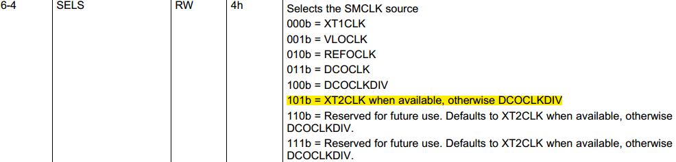

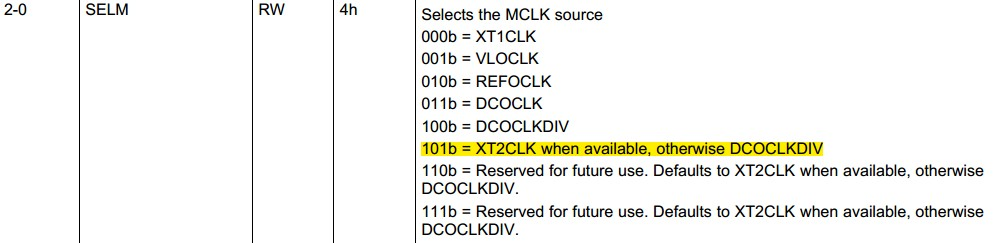

First,if XT2BYPASS mode has been used,according to slau208q,XT2 is powerd down.Does this mean XT2 is powerd by external
TCXO independently?If I want to turn off XT2 to save power before going to LPM3,turning off the TCXO's power supply will take effect?
Second,if I use XT2CLK as the source of MCLK and SMCLK,then turn off XT2CLK.How long will it take for the switch from XT2CLK to DCO?Is this
switch done automatically?If not,how can I swtich manually?
Best Regards
1. Yes.
2. Yes automatically, please refer to chapter 5.2.12 UCS Module Fail-Safe Operation
