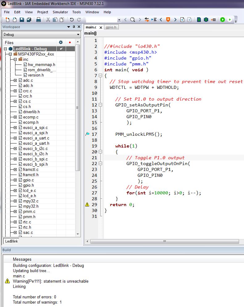

Currently I am using msp430fr2433 launchpad development kit(MSP-EXP430FR2433).
I checked 5v by connecting USB port of eZ-FET Debug Probe.
And Led102(on Demo board) glowed yellow color.
But, 3.3v is not checked anywhere on the board.
(I think... Supply eZ-FET USB Power and this power rail to 3.3 V for eZ-FET operation.)
In addition, I used the blink led example provided on the Ti homepage. And tool is iar7.2for msp430.
The IAR tool looks like board is debugging.(Attach picture)
What am I doing wrong? What should i do to use 3.3V?

    Yes, the MCU uses 3.3V, and consequently you should see 3.3V on LED1. If you're not seeing LED1 turn on, then include the following line of code after line 63:
    PM5CTL0 &= ~LOCKLPM5;
    What that line of code does is disable the GPIO power-on default high-impedance mode. This should allow you to turn the LED on and off.

  • I wrote PMM_unlockLPM5(); at line 71.
    But, 3.3v is not output. and no blink LED1.
    This code was provided by TI.

    But, LED1 is no blink and 3.3V flows at P3.1, P1.5.
    Below picture is my project.
    I don't know the solution.
