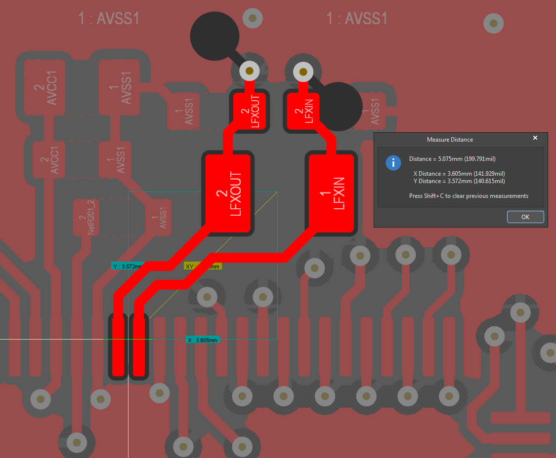

       I would recommend focusing on the crystal oscillator circuit and using a simple example to troubleshoot and make sure that the HW is working properly.
    (1) Is the drive strength to high?
    (2) Are the loading capacitors the correct value?
    (3) Is the crystal close to the microcontroller?  Are good routing practices followed.
    (4)  Does the crystal fail to startup only or does it also fail during the application (due to noise or some other EM event)?

    (3) Yes, I think so.   The layout is below.  There is 5mm from the middle of the oscillator to the middle of the pads. You can see vias through to ATE pads on the bottom of the PCB.  For what its worth, there is a reasonably solid ground plane under the micro, and a metal can over the micro and the oscillator.

        It is possible to overdrive the crystal.  Do you see an appreciable decrease in oscillator faults using the lower setting?   It is possible that the lower setting will increase the startup time.   Ideally the load capacitors would be between the device and the crystal, but I cannot say that is exactly the cause of your specific issue.
    Is the board relatively clean?  Any residue such as flux or residue from no-clean flux still present?
