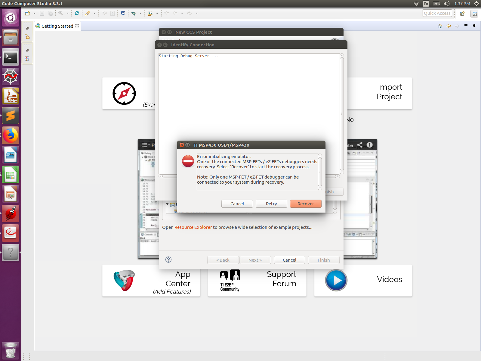

We have purchased several new LaunchPad MSP-EXP430G2ET development kits to replace the older MSP-EXP430G2 kits we have been using.  We are currently using Energia to program our MSP430s and are having an issue where we are unable to program the new kits.
When a new kit is first connected, the default example that is preloaded works (i.e. both LEDs blink).  However, when I try to upload the default Blink sketch to the new board, it freezes up and only the green light on the programmer side of the board remains lit.  Energia gives the following output:

Note that the board was connected but becomes disconnected during programming.  After this, there is no available port from the Tools menu and the MSP430 cannot be programmed.  Subsequent attempts at programming the MCU result in the following output:

error: MSP430: Error initializing emulator: One of the connected MSP-FETs / eZ-FETs debuggers needs recovery. Select 'Recover' to start the recovery process.  Note: Only one MSP-FET / eZ-FET debugger can be connected to your system during recovery.
Updating Firmware
error: MSP430: Error: MSP-FET / eZ-FET recovery failed
Failed: MSP430: Error initializing emulator: MSP-FET / eZ-FET recovery failed
the selected serial port
 does not exist or your board is not connected
This has happened with multiple kits.  I am using the 'dslite' programmer from the Tools menu and have the most recent board libraries installed.  As far as I know, there is no way to "select Recover" from Energia.  Do I have to install CCS?

  • I have resolved the issue.  This seems to be a problem for anyone that wants to develop out-of-the-box using Energia instead of CCS.  If you try to upload code onto a new board with Energia the first time, you will brick the programmer.  Luckily you can easily recover it using CCS.  Here's the fix:
    1. Before trying anything with Energia, install CCS and make sure you have everything for MSP430 support installed
      1. if you have already bricked your MSP430 kit, this process will still work (see below)
    2. Start a new project and choose "MSP430Gxxx Family" for the Target and then the MSP430G2553 from the dropdown on the right
    3. Plug the kit into the computer using the micro USB cable and then click "Identify..."
    4. If your device was bricked by Energia, you will get a prompt to recover.  Click recover.  If this is not the case, skip to step 5
    5. A new prompt will appear and you can update the firmware.  After this, Energia will recognize the kit and you will be able to upload programs!
    Hopefully someone finds this helpful!  Here is the proper output from Energia when you upload the example Blink sketch:
