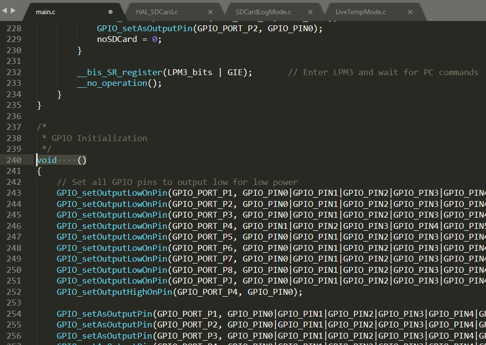

  • There is an error in main.c of the OutOfBox demo. Init_GPIO function name is missing on line 240 (see screenshot). The source as it is doesn't build, so if the binary was compiled from it, it won't work. Adding in the function name makes it run as expected.
    Please fix it in an update so that others don't run into this issue.

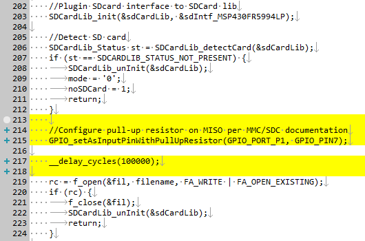

    2. We can try enabling the pull-up on SOMI line.
    We are aware of this page which has the following comment:
    Although the OOB didn't seem to have problems, we are aware of other SD Card implementations where this was an issue. So, it would be good to try the following code:

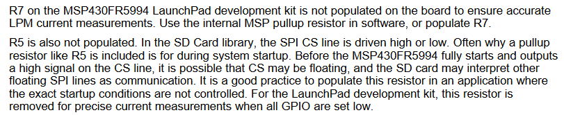

    3. It might be good to try populating R7 and R5.
    Section 2.2.5.1 in the Launchpad User's Guide (SLAU678) has the following note:
