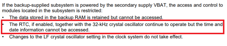

  • Hi Krishna,
    Please find the description on Device User's Guide section 3.2 Battery Backup Operation:

  • Team, Any update on above query.
  • As per my understanding, RTC can be updated during power off, using battery. With an example source code available in internet, i could able to test it. But when i integrate it to my application, its not working as expected. The extra work i have done in my code is more about  Increased controller frequency upto 20MHz. Will it have any impact?
    I don't think it is related to the controller frequency.
    If you are supply by battery to RTC, you can't access to the time and date information as described on the document.
