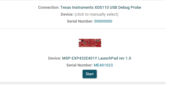

I am trying to flash the .out file into the msp432e401y launchpad using UniFlash by using external xds110 debug probe.
I have removed jumpers related to JTAG Signals & 3.3V jumper, 5V jumper on the J101. Only remain are txd, rxd and Gnd jumpers.
After opening the UniFlash software it has able to successfully auto detect the target device. And it has shown below.

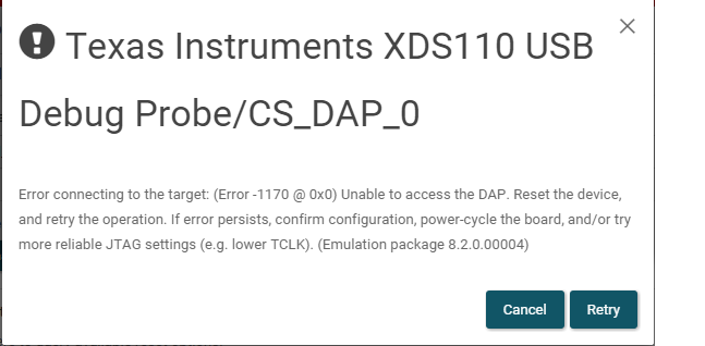

After Loading the .out file. I am getting the error like below:
As mentioned in the above i reduce the jtag clk to 1.0 MHz and try to upload but the problem persists.
Please help me.

    Can you check if you are able to program with the XDS-110 on the LaunchPad?
    Sai
    Today once again i tried with the Launchpad, Initially i got error like "SC_ERR_PATH_BROKEN" and some times one more error like "Insufficient voltage",Later i tried once again by keeping 3.3V & Gnd jumper @J101 connector and removing the all jtag signal jumpers as well as 5V jumper , I got the test connection right.
    And then ".out" file loaded successfully.
    With uniflash i haven't tried again.Later i will see.
