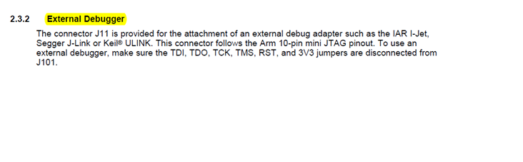

As mentioned in the launchpad datasheet, i have removed e TDI, TDO, TCK, TMS, RST, and 3V3 jumpers of J101 connector and
connected a  10 pin  connector to the J11 from external debugger cable.

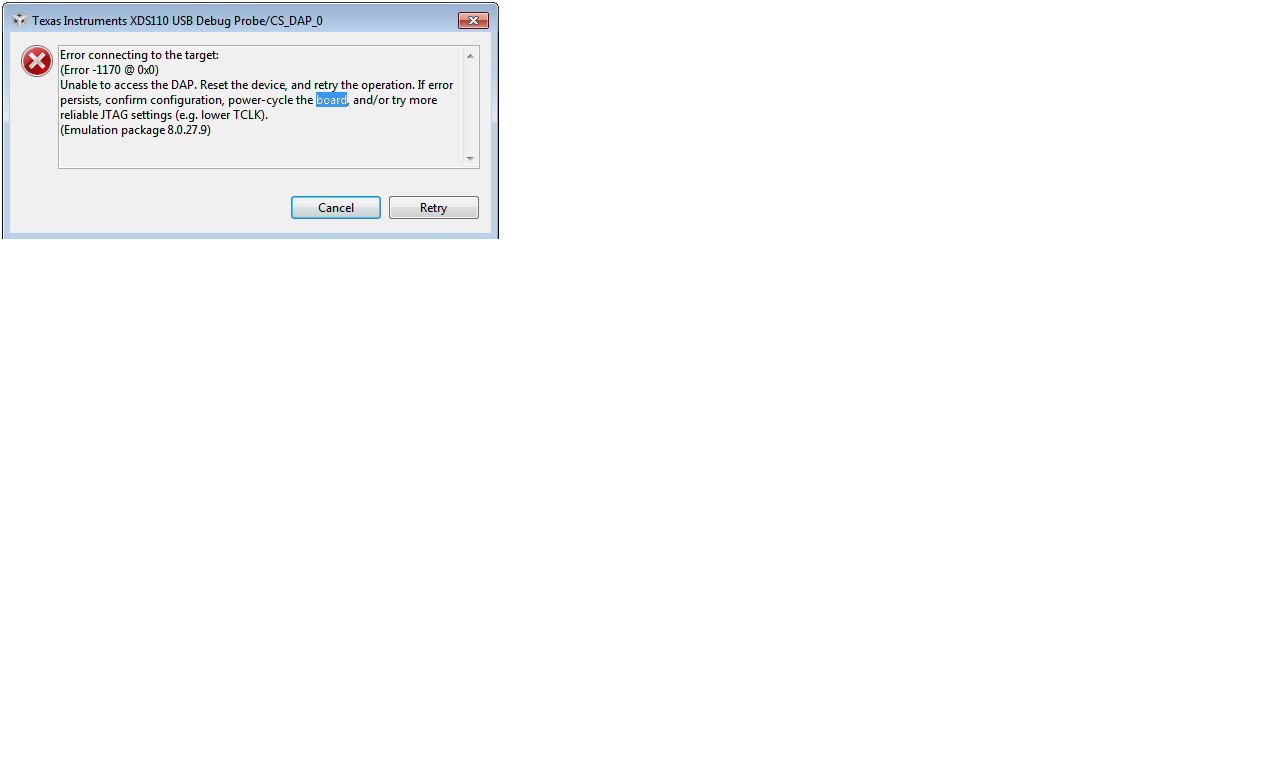

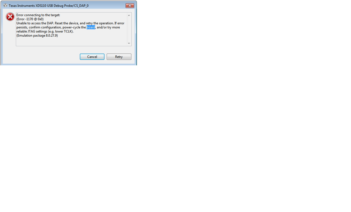

And i try to flash the program file from ccs. Then i got the error like:
please  explain me how to resolve this issue.
