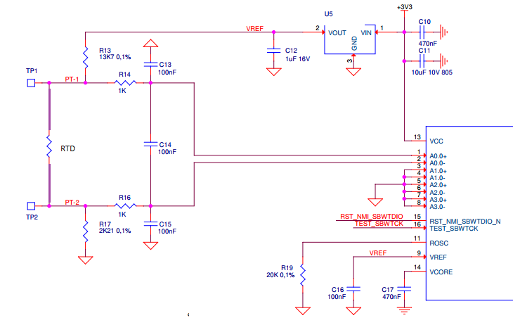

    I use only A0 input in differential mode with the following circuit:
    A1, A2 and A3 inputs are all tied to AVSS.

  • Hi, Alessandro,
    I mean it is fine that You discard first 13 conversion data and make average for 8 conversion results.
    Sorry, I cannot see the circuit you attached. It is showed as a small symbol. If the A1, A2, and A3 are tied to AVSS, it should be ok. But it seems the A0 and A1 are not connected to the same GND point. Do you have measure the voltage difference for A0 and A1 when setting them to GND?

  • Hi Lixin,
    I try to attach my complete analog input circuit.
    So, you can see A0 is the used differential input, A1 input is tied to AVSS.
    SD24 offset error on A1 was achieved converting A1 input with the same gain and average procedure used on A0 input. Because A1 is tied to AVSS, I suppose (am I right?) A1 conversion value could be the compensation offset value to be subtracted from every A0 conversion value. But when I set Vin = 0V (i.e. RTD = 0 Ohm) on A0 input, I read a much greater value then the compensation offeset value.
    Alessandro
  • Hi, Alessandro,
    Thanks for the schematic attached.
    RTD=0-ohm cannot be regarded same as A1 input which is connected to AVSS directly. You can cut off the components on A0 circuit and connect A0 to the same grounding point AVSS as A1 input. Then do the ADC conversion again to check the difference between A0 and A1 channels.
    For your circuit, A0 input is connected to the VREF through resistors and capacitors. For offset calibration, the voltage between A0+ and A0- should be 0. It is recommended to remove R13 and R17, short RTD, R14, and R16.
    I don't know what is the function for R13 and R17. It seems to provide voltage to external circuit. I am not sure if they will impact the offset result. If the resistors will work in normal application, maybe they need to be reserved for the offset calibration, i.e. RTD=0-ohm as your mentioned method.
    If you want to use A1 conversion result as the offset compensation value, it is recommended to connect the same input circuits as A0 except the RTD is 0-ohm.
