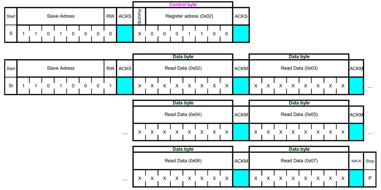

I am trying to  configure BMI160 IMU's (sensor) registers and then read the information. Based on the BMI160 datasheet:
1- The read access should be like
 The read function based on above figure is: (First master transmitter->slave address->register address->repeated start->slave address->read data->...->NACK->Stop)

The problem I have here that the code get stuck in the
 if (i)
     {  __delay_cycles(300000); // ~100ms pause between transmissions
         while(!(EUSCI_B0->IFG & EUSCI_B_IFG_RXIFG0)); //Wait until the data in TXBUF(register address) is transmitted
         EUSCI_B0->IFG &= ~(EUSCI_B_IFG_RXIFG0); //Clear the flag
My question is that did I write the correct format for read access?
