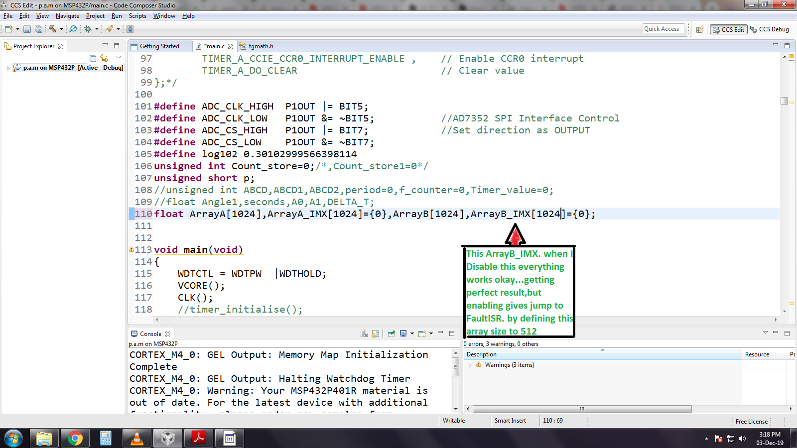

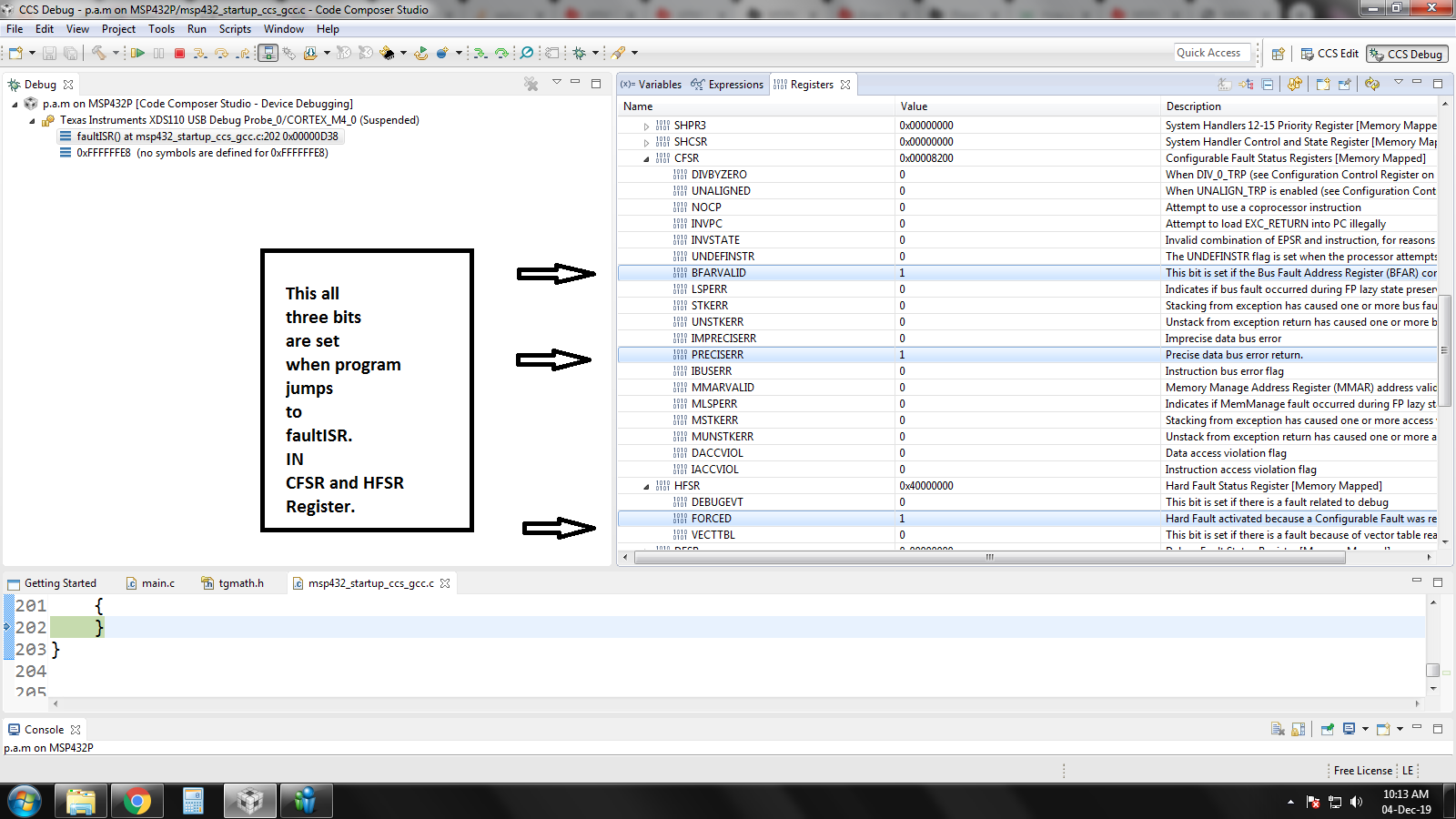

I am facing a problem that is when I enable one array of 1024 Program jumps to FaultISR, by defining Array size to 512 everything works fine.

Please refer to this related thread: https://e2e.ti.com/support/microcontrollers/msp430/f/166/t/617423?MSP432P401R-FaultISR-How-to-know-what-causes-it-
