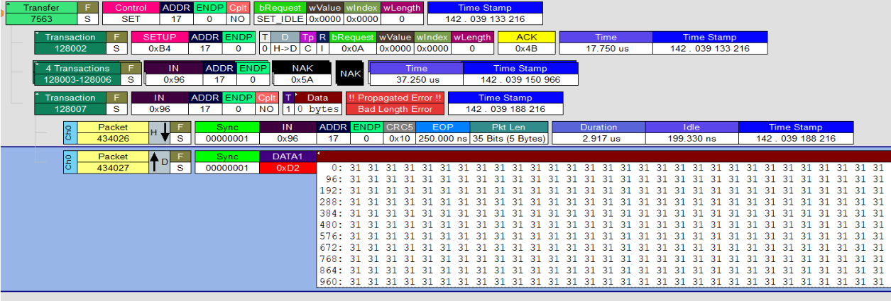

We've had a failure which has been reported on field units in which a device drops off the USB bus during operation.  The MSP430 is connected internally to a device running Linux kernel 4.x and 5.x, and we've seen in both kernel environments. Software is polling for a HID report descriptor approximately once per second when the error occurs.  Since the USB connection is internal to the end device, the customer needs to reboot in order to resolve. We've noticed this problem appears to occur more frequently on specific silicon for reasons not understood.
I've noticed I can easily reproduce the problems associated with the USB10 errata on any hardware (including a TI MSP-EXP430F5529 development board/H7_Mouse example) in a Linux environment if I use https://github.com/DIGImend/usbhid-dump in a script which loops on the vid/pid combination.

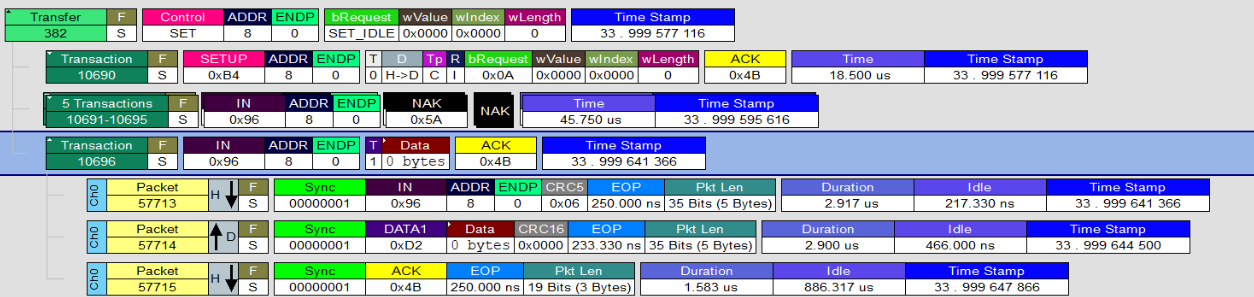

The device drops off the bus consistently in <10 minutes of testing in this scenario, and I can see the device spewing data on a USB analyzer trace.  Every time I've caught the issue thus far it's been on a SET_IDLE Request. Here's an example capture from the analyzer of the failure (when running H7_Mouse TI reference example on an MSP-EXP430F5529 development board):
Here's the normal successful handling of SET_IDLE:
Making the one line change to include the USB10 errata workaround with #define USB10_WORKAROUND 1 in usbIsr.c resolves the issues with the usbhid-dump script and makes it so the script can run indefinitely without the device dropping off the bus (I've gone as long as several days and have never seen a failure.)

    Can you add any detail about what I should see on the USB interface when the orphan packets or orphan tokens are sent?  Will these occur on every SETUP packet? Or only on SETUP packets when the CRC timing issue would have previously occurred instead?
    This is failure scenario:
    - USB host sends a SETUP packet to the device (MSP430)
    - SETUPIFG is set on first bit of ACK response of the device (MSP430)
    - USB host sends a data packet (IN/OUT) to endpoint 0 of the device (MSP430)
    - SETUPIFG is cleared during the 2nd bit of CRC of the EP0 data packet
    I must say I am not an expert on Linux and USB stack. Hope this can help you.
