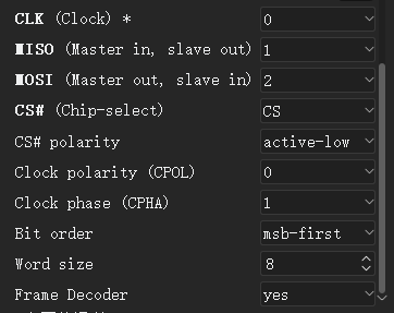

But in my logical analyzer, the result is wrong. Here is my setting in logical analyzer:

The result will be right. But in this situation, the SPI clock should not be CPOL_low and CPHA_high.
Could anyone tell me what mistake I made or some part I ignored?

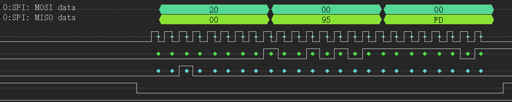

    Can you post a screenshot of wrong code wave and right code wave?

    FR2355 is used as master, I have set the UCMST as 1. Here are the code waves(Please ignore the MISO data):
    1. Correct
    2. Wrong(Sending the same data as above--0x20)
  • In conventional usage, UCCKPH=1 corresponds with CPHA=0 (and vice versa).
