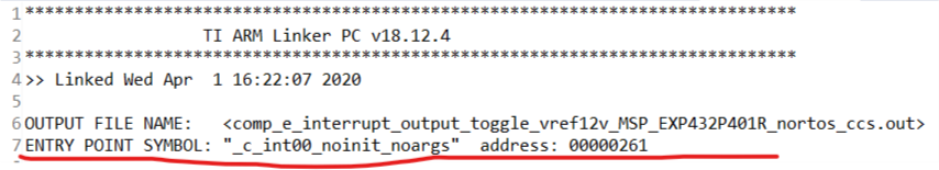

    1. If you use CCS, you can find the main function entrance from .map file, like this.

  • Hi Eason,
    Thanks for the information , but for our project we are not using css. We are using gcc for creating bin files. The lds file i am referring to is msp432p4111.lds file which has the memory sections defined it in simplelink library. I want to be able to load two image files onto MSP432 and switch between the two images present on MSP432.
    Also I notice on Uniflash we have the option to load multiple image files and we can specify the load address , but on loading two images onto MSP432 how do i switch between the two images. It would be helpful on what i should do to switch between the two images.
