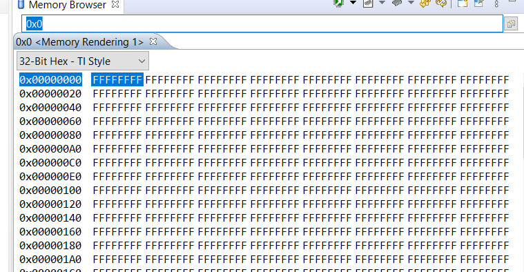

Then I run a target configuration -> Run -> Connect Target -> Script -> Defaults -> MASS FLASH ERASE to erase main memory as shown here:

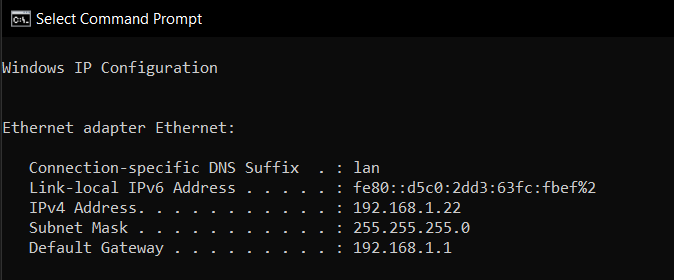

Also I know my IPServer is 192.168.1.22 because of ipconfig:
I have tried using other IP addresses for the IPClient field on which ping command fails.
