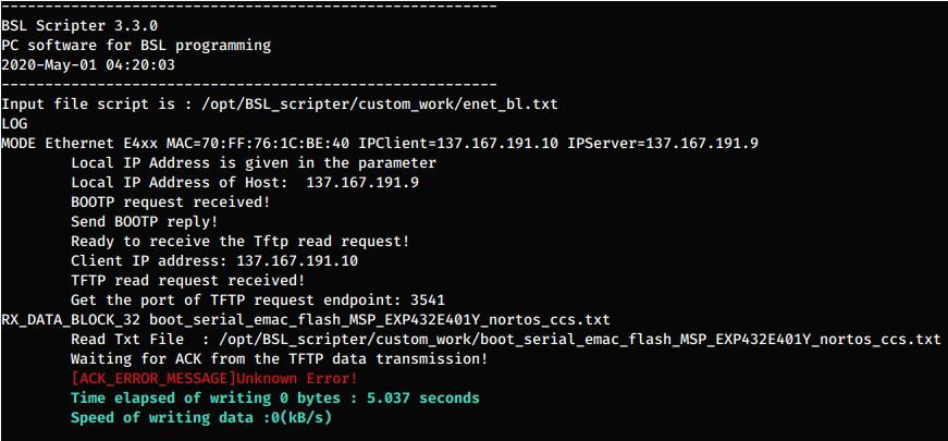

I read how to upload custom bootloader in msp432e401y board and did everything correctly, but this error is coming up and I am not sure how to resolve this

It looks like you're performing an Ethernet Update. I found the following NOTE in Section 4 of the MSP432E4 SimpleLink™ Microcontrollers Bootloader (BSL) User's Guide.
NOTE: When using the Ethernet update, the bootloader can not update itself since there is no mechanism in BOOTP to distinguish between a firmware image and a bootloader image. Therefore, the bootloader does not know if a given image is a new bootloader or a new firmware image. It assumes that all images provided are firmware images.

Thank you for replying, I did everything as shown in guide, but still I am getting this error.
Are you trying to update the bootloader or reflash the firmware? In the NOTE included above, it doesn't look like you can update your bootloader using this method.
