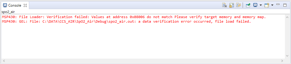

I try to download software to the MCU on the target board using SBW, but I got the attached error message.
However, there is a case where an error is not caused if I set different value to the variable.
<Download successfully without error>
param.clockPrescalar = 4;
param.firstModReg = 3;
param.secondModReg = 5;
param.overSampling = EUSCI_A_UART_OVERSAMPLING_BAUDRATE_GENERATION; // 1
An error occurs if you change any of the above values.
<error occurs>
param.clockPrescalar = 12; ←Change "4" to "12".
MCU: MSP430
Tool: CCS v10
OS: Win10
Can you tell me the reason?

What specific MSP430 device are you using? Are you using MSP-FET? Did you rebuild and/or clean your project after making these changes? Is param.clockPrescalar = 12 a valid setting?
These types of errors are challenging to resolve but sometimes, creating a new workspace and project can help.
CCS/MSP430FG4618: File Loader: Verification failed when adding BSL as in slaa600d
