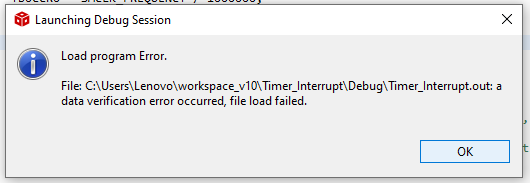

I faced an error as
MSP430: File Loader: Verification failed: Values at address 0x08170 do not match Please verify target memory and memory map.
MSP430: GEL: File: C:\Users\Lenovo\workspace_v10\Timer_Interrupt\Debug\Timer_Interrupt.out: a data verification error occurred, file load failed.
Below is the code i'm trying to load to the target device but getting error as above. I have configured 24Mhz clock to SMCLK and generating interrupt using TimerB0.
Didn't understand what is the mistake and why it is no loading to target. Please help me to solve this error.

  • Add this line before you configure the clock:
    > FRCTL0 = FRCTLPW | NWAITS_2;   // FRAM: 2 wait states
    I can't say for sure that this is the cause, but running the FRAM too fast will cause unpredictable behavior.

  • Thank you Bruce,
    I will check it now. So you mean to say we can't configure SMCLK to 24Mhz?

  • You can configure SMCLK=24MHz. But in the process you will also configure the CPU clock, MCLK=24MHz. In that case, the CPU will try to read FRAM at 24MHz, and it will fail (8MHz max). That line of code forces 2 wait states when reading the FRAM, to slow it down to 8MHz.
    As I mentioned over in the other thread, taking an interrupt every 1 microsecond is infeasible, even at 24MHz, since the ISR takes too long. I suspect there's another way to do what you want to do, but I'm not clear what that is.
  • Hello Bruce,
    Thank you, Code is working fine with the line you have suggested below.
