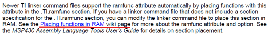

Does Placing functions in RAM help?BIt_Banger said:How can I map these functions to RAM locations using Code Composer Studio?
That is very helpful, thank you.
Apparently using the __attribute__((ramfunc)) construct not only maps the functions to RAM but loads them there as well at startup, so I don't need to do it manually and I can remove our legacy function that does that. I discovered ".TI.ramfunc : {} load=MAIN, run=SRAM_CODE, table(BINIT)" was already in my command file, and when I looked at the memory map I was able to verify that the functions mapped to RAM were actually at the locations in RAM specified by the memory map by using the memory browser.
