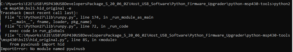

    I have try use the bsl5 in win10 but failed due to can't find the folder pywinusb. Have you try it in the win10 before?
    This is the error I get
    I am seek the help from other people now.

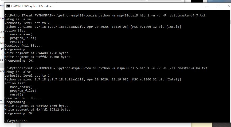

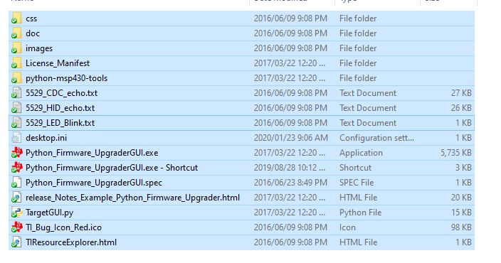

  • Good Afternoon Gary
    I managed to flash a device using Python masp430.bsl5 in command line. I had to copy Python_Firmware_Upgrader files (see below files) to the Python directory to work - would not work by just adding Python directory to the path even after restarting my machine.
    Also, I had to download Python-2.7.18. Could not get it to work on the latest Python-3.8. Please see successful programming below:-
    Programming in Linux still remains an issue.
