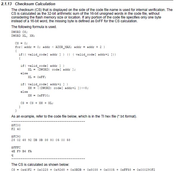

I tried to calculate the checksum as described below.
However, the result is not equal to CS value in GANG GUI.
Is the method of calculating the checksum between this manual and the GUI of GANG different?
MSP430F5324_Checksum_Test.xlsx
@4400 81 00 00 34 B1 13 30 00 0C 43 B1 13 00 00 1C 43 B1 13 2A 00 32 D0 10 00 FD 3F 03 43 @ffd2 14 44 14 44 14 44 14 44 14 44 14 44 14 44 14 44 14 44 14 44 14 44 14 44 14 44 14 44 14 44 14 44 14 44 14 44 14 44 14 44 14 44 14 44 00 44 F1 03 B2 40 80 5A 5C 01 D2 D3 04 02 D2 E3 02 02 B1 40 10 27 00 00 81 93 00 00 F8 27 91 83 00 00 81 93 00 00 F3 27 FA 3F 03 43 03 43 FF 3F 03 43 1C 43 10 01 q

Manual is SLAU358 MSP-GANG UG.pdf.SLAU358 MSP-GANG UG.pdf

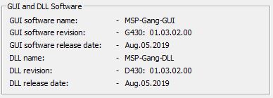

MSP-GANG version is follows.
Sasaki
Sasaki-san,
I recalculated in the 2nd sheet of your excel file and here it matches the CRC from MSP-GANG so something in your Excel calculation is wrong.
Please find the file attached.
Hi Dietmar-san,
Thank you for your support.
I was making the wrong calculation.
