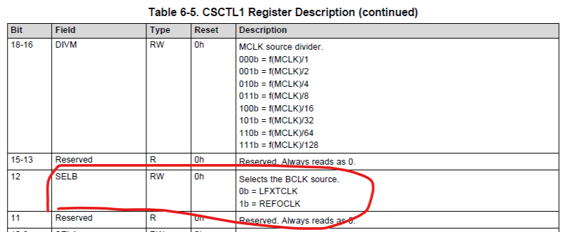

- The variation is seen regardless BCLK source (either REFOCLK or LFXTCLK).
- Customer uses below code to switch REFOCLK and LFXTCLK.
 When .SELB = CS_LFXTCLK_SELECT is enabled, customer confirms the external crystal start-up as expected.

.SELB = CS_LFXTCLK_SELECT,
.SELA = CS_LFXTCLK_SELECT,
// .SELB = CS_REFOCLK_SELECT,
// .SELA = CS_REFOCLK_SELECT,

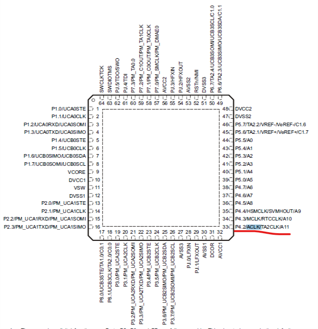

    I must say the RTC accuracy is depends on crystal frequency. I advice you to output ALCK to check if the crystal is right.
    The default BCLK selection is LFXCLOCK.
  • Hi Eason,
    Do you mean the RTC should not show such variation as far as customer uses accurate crystal?
    Thanks and regards,
    Koichiro Tashiro
  • Yes, that is what I mean! To ask customer to output the ACLK is to check the frequency error.

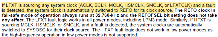

    Customer found LFXTIFG bit is set in CSIFG register.
    According to TRM, the default value of this bit is 1 and if this bit is set, BCLK source is automatically switched to REFO.
    TRM section 5.2.10 Clock System Fail-Safe Operation.
    We guessed this is the root cause of the issue as REFO does not have enough accuracy.
    Customer added the code to clear LFXTIFG bit just after start-up.
    After that modification, RTC accuracy is within +/-1sec for 4hours.
