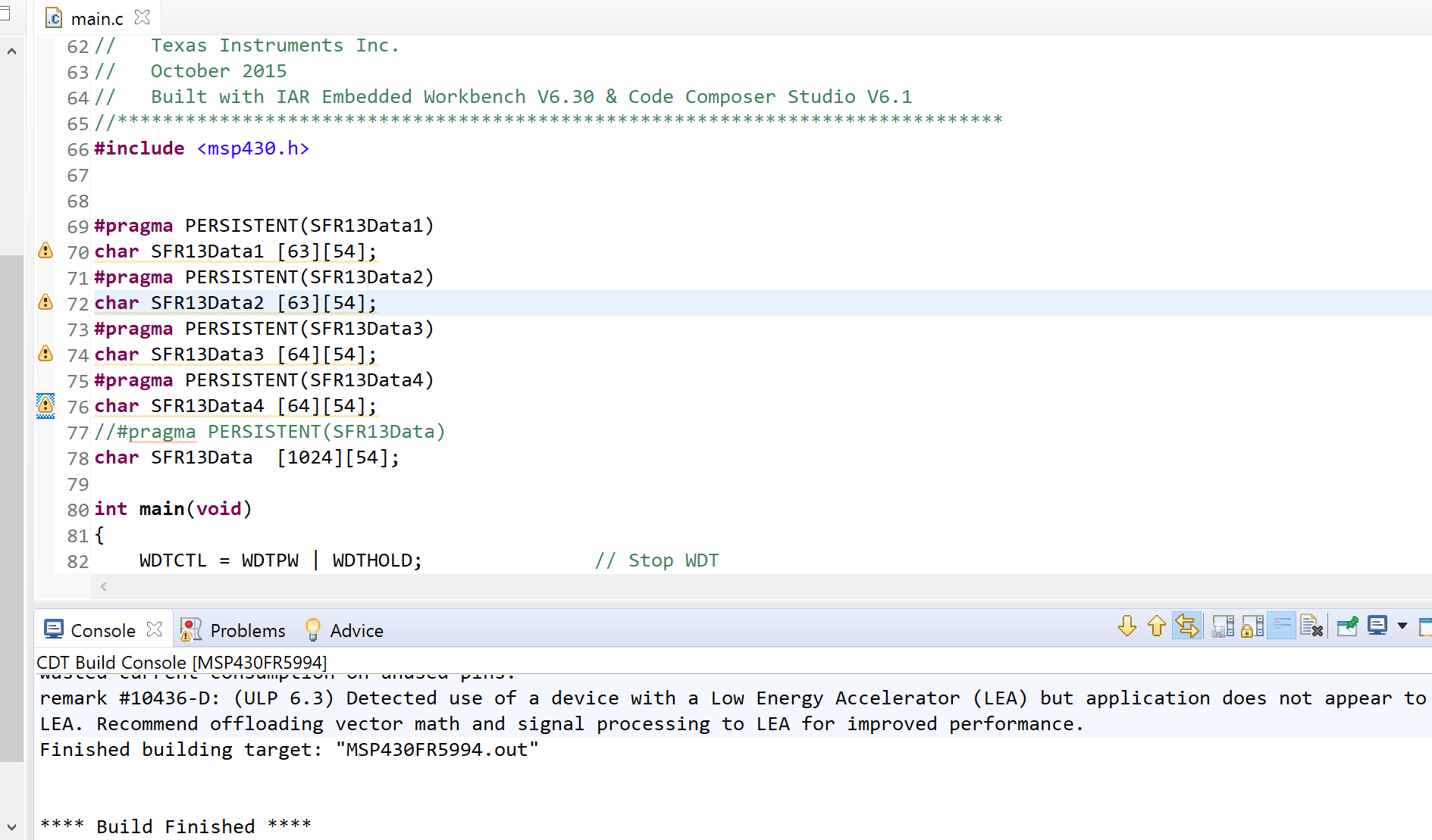

#pragma PERSISTENT (SFR13Data) // SFR13 データ記憶
char SFR13Data[DimMax][54] ;
I want to put 1024 54 character data.
DimMax 63 is OK.
However, when DimMax is 64 or more, the error of #10099-D is output and the variable cannot be secured.
How can I reserve more than 64 array variables in FRAM?

    It is OK to declare the above three. However Next, one declaration will result in an error.
    #pragma PERSISTENT(SFR13Data)// SFR13データ記憶
    char SFR13Data [64] [54];
    I want to declare  char SFR13Data [1024] [54];
    The following error occurs.
    It is pointed out that the physical memory is insufficient.
    However, the FRAM physical memory has an extra 100 kbytes.
    Then, by declaring the 54 characters by changing the variable name by 63, memory is secured.
    However, trying to secure more than 64 (SFR13[64][54]) will result in an error.

  • Hi NodaR,
    I tested these variable declarations on FR5994 and do not encounter any problems. Did you modify the .cmd file?
    Best Regards
    Johnson
  • You did a memory allocation experiment.
    Thank you.
    My environment is CCs v9.0.1. The compiler version is TI18.12.2.LTS[TI v18.12.1LTS].
    I haven't modified the cmd file.
    But you succeeded, so I figured it was due to a compile condition.
    I recheck the compilation parameters.
  • Hi NodaR,
    I use CCS v9.0.1 and compiler version is TI 18.12.1, It looks like PC environment is the same.
    Best Regards
    Johnson
  • Johnson's Hello
    I saw your pointed out cmd file.
    I fixed it.
    The error is gone. Thank you
