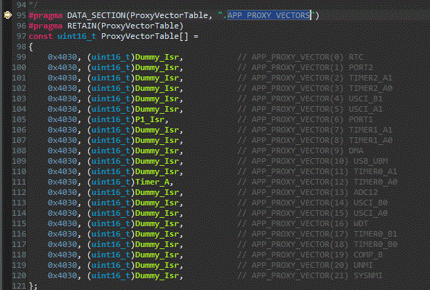

So, when I debug the bootloader, I expect my device to have a variable Vector_Table placed at BOOT_VECTOR_TABLE (which shold be 0xFFE0) and start with a value of 0x1234. But it seems the table is not placed at all or in the wrong place, because when looking at the memory at 0xFFE0, there's just 0xFFFF until the reset vector finally is placed. Can you give me some hints?
  • Hi Torben
    There are many solutions to handle the interrupt vector. For the solution mentioned in MSPBOOT_2_00_00_01. It use a array placed at application's code to contain the start address of the ISR as below
    the 0x4030 in the original code was a BRA #dst (or MOV #dst,PC) instruction, followed by the 16 bit destination address.
    You can see when the interrupt happens it will go into APP_PROXY_VECTOR(x) that is means ((uint16_t)&_Appl_Proxy_Vector_Start[x*2]) and _Appl_Proxy_Vector_Start is the array defined in application code named ProxyVectorTable.
  • Thanks Gary for pointing that out... In fact, I did mess up my proxy table and the CPU executed the wrong code, but I only realized when I checked against your code.
