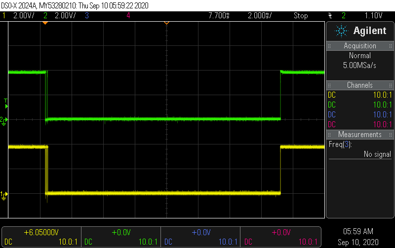

Reading 1 byte
This is what happens when reading one byte (which looks correct):
Fig 1:
These are the memory dumps after reading the data:
(mspdebug) md 0x0540 00540: c0 0f 08 00 00 00 08 00 00 01 01 00 00 00 00 00 |................| 00550: 00 00 00 00 00 00 00 00 00 00 00 00 68 00 ff 03 |............h...| 00560: 68 00 00 00 00 00 00 00 00 00 61 00 08 40 00 00 |h.........a..@..| 00570: ff 3f ff 3f ff 3f ff 3f ff 3f ff 3f ff 3f ff 3f |.?.?.?.?.?.?.?.?| (mspdebug) md 0x056C 0056c: 08 40 00 00 ff 3f ff 3f ff 3f ff 3f ff 3f ff 3f |.@...?.?.?.?.?.?| 0057c: ff 3f ff 3f 01 00 03 00 00 00 00 00 00 00 00 00 |.?.?............| 0058c: 00 00 00 00 00 00 00 00 00 00 00 00 00 00 00 00 |................| 0059c: 02 00 00 00 ff 3f ff 3f ff 3f ff 3f ff 3f ff 3f |.....?.?.?.?.?.?|

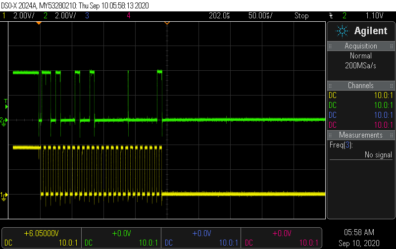

Reading 2 bytes
When I reading two bytes, the data line hangs low after the 7th byte of the third frame (second byte to be read):

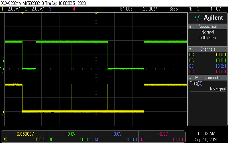

It stays low for about 15ms:
Fig 3:
These are the memory dumps after attempting to read two bytes:
    00540: c0 0f 08 00 00 00 08 00 00 02 02 00 10 00 00 00 |................|

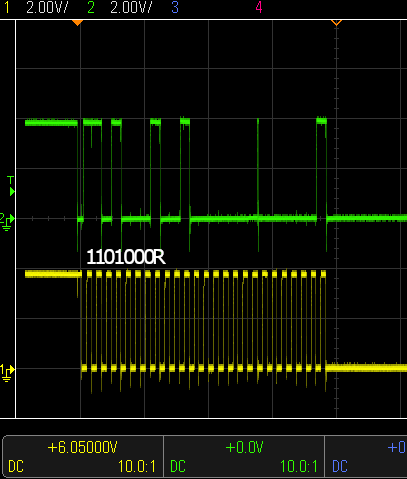

Reading 5 bytes
When trying to read five bytes, the SDA line hangs low similar to when reading 2 bytes:
Fig 4:

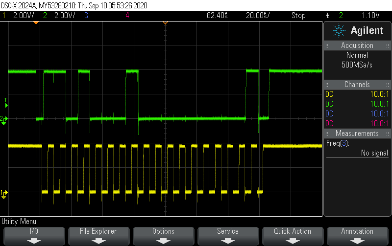

But there seems to be some attempts to start transmission again in a 130ms time frame before SDA and SCL are released again:
Fig 5:

  • What I see is starting the I2C system up to receive data (UCTR reset) but the slave address says transmit. (lsb=0)
  • Are you referring to a particular figure? (I edited the original post to add figure labels above each figure.)
    Or are you referring to line 39 in the code? UCB0I2CSA = 0x0068; // Slave address

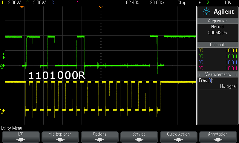

    The slave address is 1101000 which is 0x68. My understanding is that if UCTR is 0, the eUSCI module will automatically append 1 to the LSB to receive. Or, should UCB0I2CSA=0xD1=11010001? I did not explicitly set UCTR low because it defaults to low on power up. To me, Figure 1 seems correct in reading 1 byte even though the data is all 0. The transmission in Figure 1 ends with a Nack and a Stop command after reading 1 byte.
    However, in Figure 2, the same address is sent with LSB=1 for read, but only 15 bits are read, and SDA and SCL are held low. (i.e. the 8th clock cycle of the second word does not go high and remains low. The last high of SCL is the 7th bit of the second word.)
    Reading 1 byte Fig 1:
    Attempting to read 2 bytes Fig 2:
