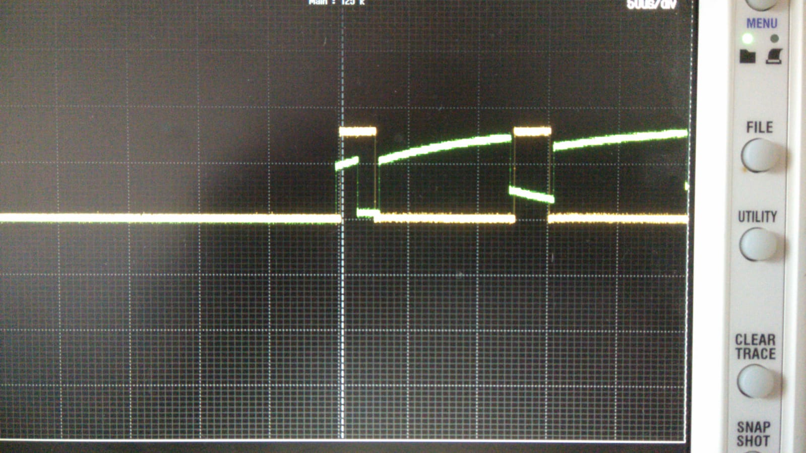

  • hi,
    thanks for your help.
    its working great now , even if i load a new value.
    but the first pulse overlap for some reason.
    why?
    thanks.
  • You have to initialize the counter value (before you start the counter) or set correct outputs states for zero counter.
    TB1R = 775; // value when both outputs are 0
