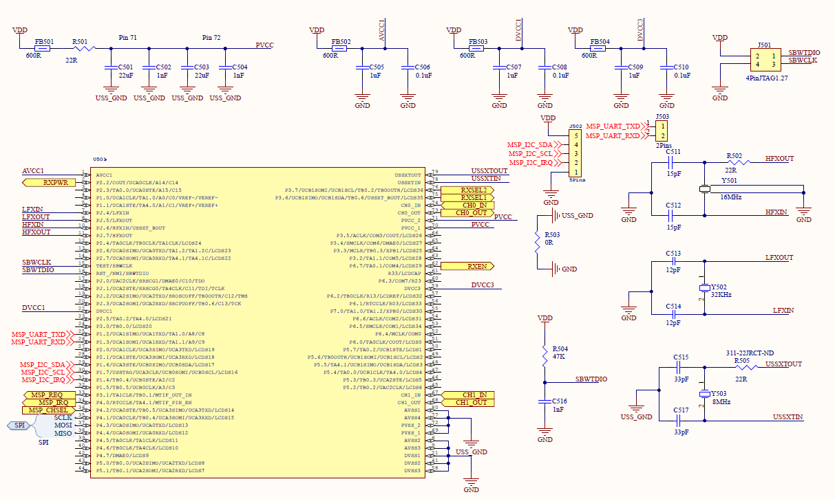

    Let's summarize what do we have and what do we want to get.
    I have two custom boards based on the EVM430-FR6043 reference design.
    1) MSP Water
    2) MSP Gas
    I use MSP430FR6043IPNR on both boards.
    I have three crystals attached:
    HFXT - 16MHz
    USSXT - 8MHz
    LFXT - 32.768Hz
    My goal is to launch these boards with GUI provided by TI in USS Lib.

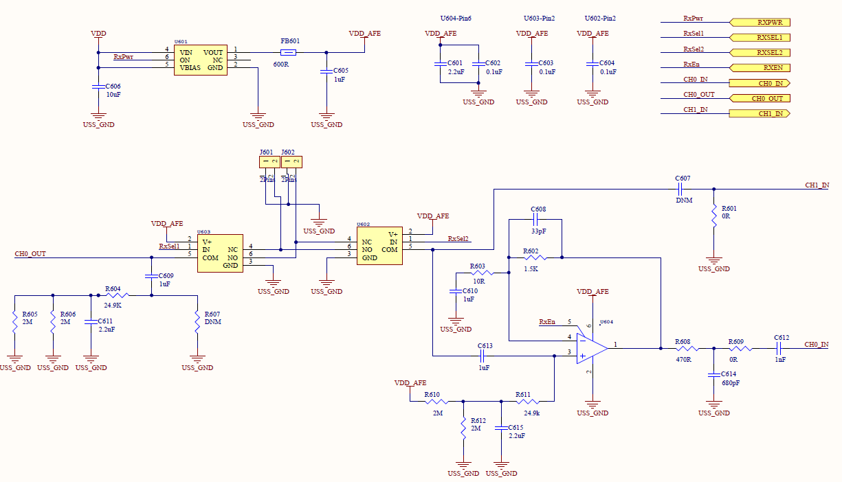

    ad1)
    MSP Water has a basic AFE without a preamplifier, see the schematics.
    ad2)
    MSP Gas uses an additional preamplifier along with a switching concept based on the above-mentioned reference design, see the schematics.
    According to this conversation (e2e.ti.com/.../931497), I use CAPTIVATE-PGMR to connect my custom boards to the GUI.

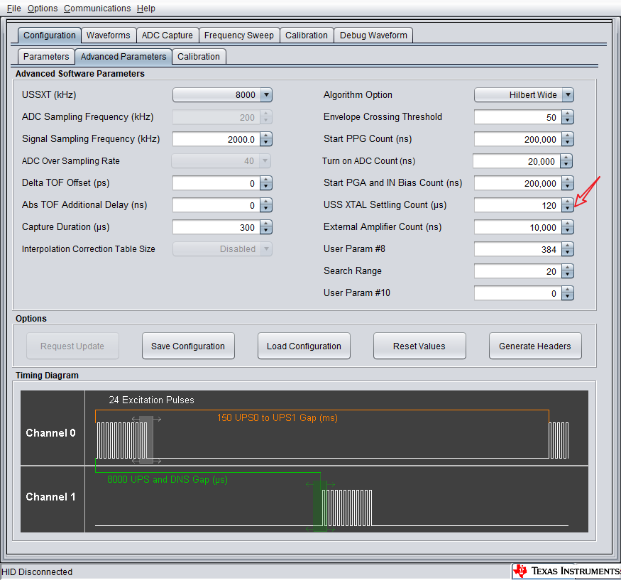

    Why do we see this error in GUI - no.24 "HSPLL detected that the PLL has unlocked"?
    Please guide us, how to debug the source of this error?
    Adam
  • Hi Adam,
    I have a look for your schematic and don't found some issue.
    And there have a possible problem here, you can check it:

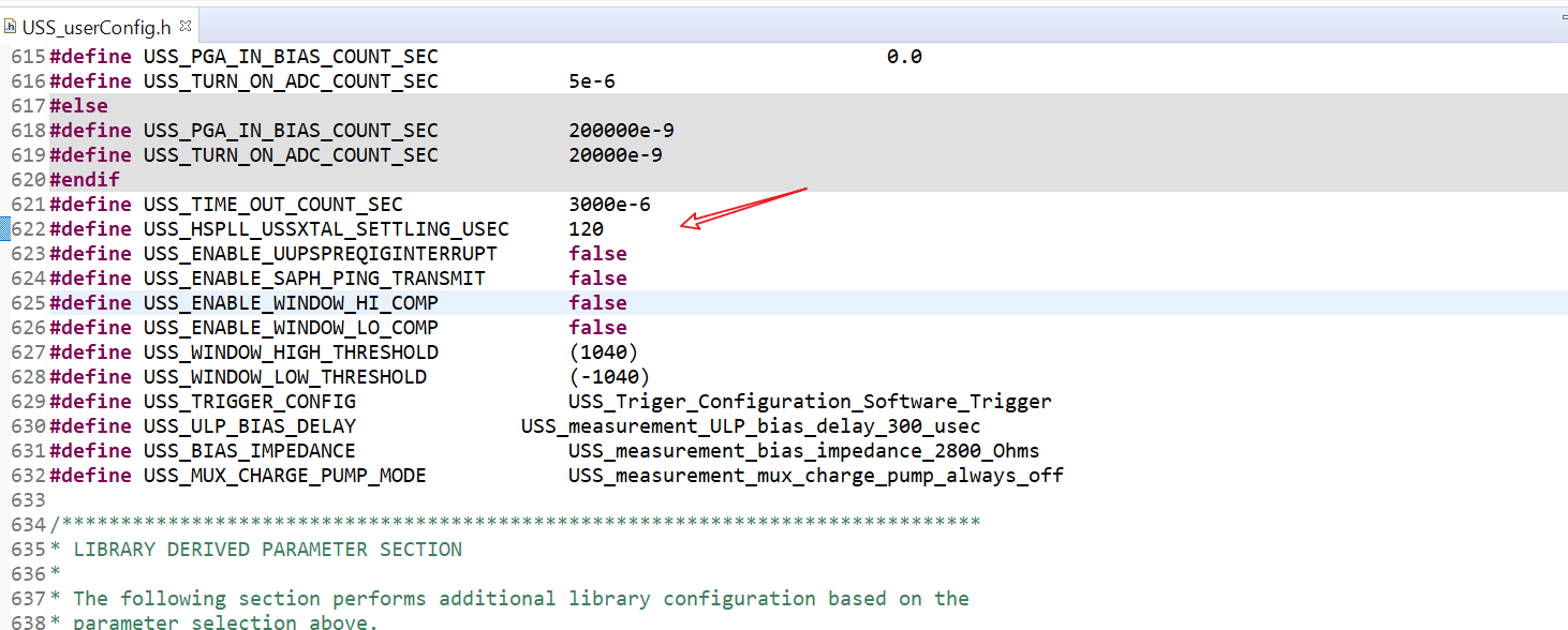

    For the USSXT, in your schematic, it's Y503. This is a crystal or resonator?
    We use a resonator in the EVM, so 120us is set in our fault image.
    But if you are using a crystal, this time needs to be set to 4000us to meet the start-up time of the crystal oscillator.
    And if you don't change this parameter, maybe you will encounter connect fail or HSPLL locked fail issue.
    In order to resolve this issue, you need to change this parameter in code, and rebuild project.
    # You need to change here in code:
    #Shot -Advanced Parameters
    Thanks!
    Best Regards
    Johnson
  • Hi Johnson,
    Yes, it was exactly this parameter.
    We've already found this issue today.
    Both water and gas are working properly when we increase this time to 2000us.
    Thanks for your assistance.
