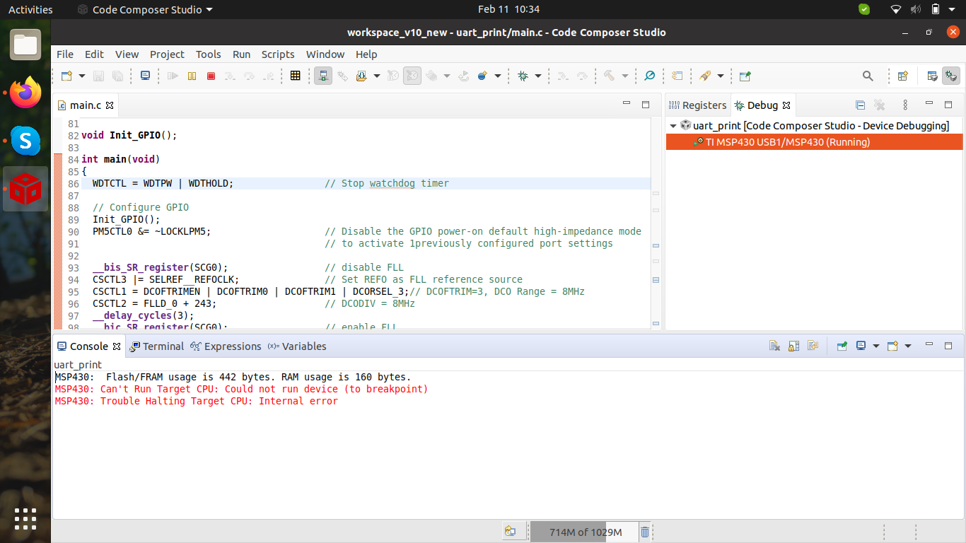

I am trying to print data on console as per mentioned in this post
https://e2e.ti.com/support/microcontrollers/msp430/f/166/t/788144
I am using MSP430FR2433 dev board and running CCS- Version: 10.1.1.00004 on linux environment.
I want to print debug messages using uart through usb connected to power up and debug board. I followed the same code as mentioned in the above post and when i try to run it, my CCS gets halted and it gives me error :
MSP430: Can't Run Target CPU: Could not run device (to breakpoint)
MSP430: JTAG Communication Error
I dont know what wrong i am doing. It will be great if anyone can suggest me possible reasons of not working or guide me how can i achieve this.

    No i haven't change anything in the code except one change what he suggested in his answer.
    I tried what you suggested, i put breakpoints at different points like after GPIO initialize, UART initialize, it works till there even in the while loop there is no problem with the code.
    Problem starts when i initialize terminal to get data, CCS gets hang and LED101(Red) continuous ON state.

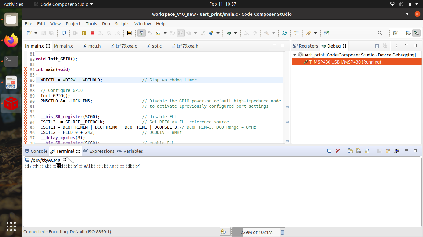

    Actually i am trying to send data from board to PC, so that i can implement PRINT functionality for debugging purposes. This is my first priority, and sending back data from PC to board will be additional thing i will try to do later.
    Even though i tried to implement this functionality also using the sample code you shared and still i am not getting the correct response. If you can see in below image, i am getting garbage values when i press any key, and after few minutes board get halted
    Those results are with RXD and TXD Jumpers are connected to the J101 header.
    Baud rate - 9600 (as per the configurations in the code)
    OS - Linux
    Serial port - ttyACM0 (I can see ttyACM1 also, and when i reconnect the usb cable it shows ttyACM1 and ttyACM2) not able to understand which i need to use as there is no proper documentation i found for Linux environment, which is supposed to be present if TI is giving Linux support but i can see very little information is present )

  • Hi Dennis,
    I am able to resolve my issue by using this sample code:-
    https://dev.ti.com/tirex/explore/node?node=ALmjIxqCiPoBS2RtYoT2vw__IOGqZri__LATEST
    The difference between the the other examples is:-
    1. Clock initialization, which was not happening in other.
    2. Board rate settings is different
    Also for anyone who is working on same environment: COM port i used is ttyACM1 (for me there ere 2 COM ports ttyACM0 and ttyACM1 )
    Now i am able to send data from board to PC using Backchannel UART (no external h/w is required)
