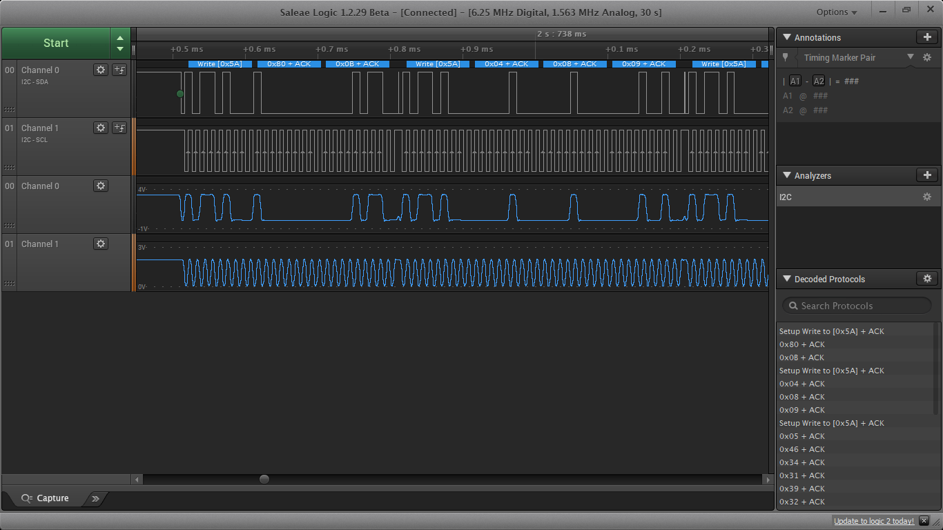

    Does it send anything? Can you post a screenshot of the I2C wave.

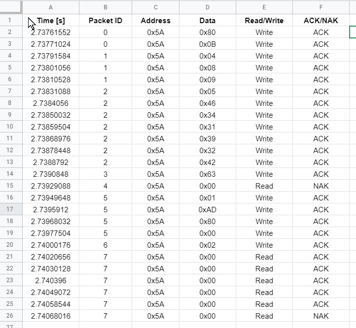

    Answer to your question #1 "What the exact problem when you use the code?":
    a. I don't understand how to use and the format of the #Define values highlighted in yellow as shown bellow.
    2. "Do you change the slave address?"
    a. Yes, I entered the slave's address as 0x5A, per the slaves documentation.
    As shown in the green highlight in 1.a image above.
    The result is that the address is written 25 times, each write also writes unknown data data, as shown in the data table from the capture below.
    Possibly it is writing data as described in Data being defined in the #Define statements? Please see my questions in the image in item 1.a. above.

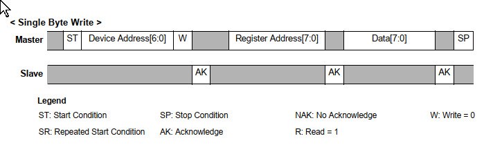

    b. The format for a Single Byte Write, per the MPR121's Data Sheet, page 22 (attached) is shown as follows:
    3. "Does it send anything? Can you post a screenshot of the I2C wave."
    a. Yes, note the screen shot of the capture and its data table.  Please see item 2 above.

  • You can see the description of the function:
    For read function: it will first write a CMD, then read the bytes you declare in  "count" parameters
