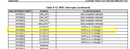

  • Hi mime,
     Please change your code from
        NVIC->ISER[2] = 1 << ((PORT2_IRQn) & 31);
    to
        NVIC->ISER[1] = 1 << ((PORT2_IRQn) & 31);
    Hopefully that should the trick. At the same time please take a look at the section 6.6.2 in the MSP432 datasheet (Table 6-12 NVIC Interrupts)

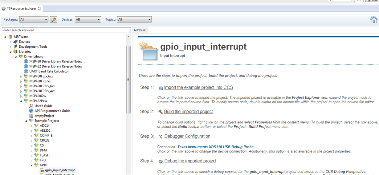

    Then I found an example, "interrupt priority masking":
    http://dev.ti.com/tirex/#/?link=MSPWare%2FLibraries%2FDriver%20Library%2FMSP432P4xx%2FExample%20Projects%2FINTERRUPT
    Strangely enough, the example uses functions that are not described in the online API of the driverlib.
    http://dev.ti.com/tirex/#/?link=MSPWare%2FLibraries%2FDriver%20Library%2FMSP432P4xx%2FAPI%20Programmer's%20Guide

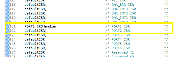

  • Hi mime,
     Sorry to hear that you are still having problmes. Quick question, did you make any modification to your startup file (startup_msp432p401r_ccs.c)??
    If not, please make sure that you include PORT2_IRQHandler similar to PORT1_IRQHandler.

    In regards to your driverlib question, you are missing some include folders in your project and the driverlib.lib so I would recommend the following:
    1. Import a driverlib project using resource explorer:
    2. Add your code for the P2.7 interrupt (main.c)

    3. Add the Port2 ISR in the interrupt Vector table (startup_msp432p401r_ccs.c)
        defaultISR,                             /* DMA_INT0 ISR              */
        PORT1_IRQHandler,                       /* PORT1 ISR                 */
    	PORT2_IRQHandler,                       /* PORT2 ISR                 */
        defaultISR,                             /* PORT3 ISR                 */

    extern void PORT1_IRQHandler (void);
    extern void PORT2_IRQHandler (void);

    when I saw the first lines of your post I realised that that was going to solve things.. and it did!
    It also explains the behaviour; if an ISR is not found, the program goes into an infinite loop.
    Many thanks. If it's not too much trouble, could you tell me where I could find the documentation that talks about the startup_* file?

    Also: I'm very confused about the gpio_input_interrupt.c example. I tried to make that example work, just as the mspware example.
    The strange thing is: ISR_PORT1 is working, and toggles the LED. ISR_PORT2 is also working: it arrives when I put a hardware trigger on
     if(status & GPIO_PIN7)
    But it never enters the if statement! It fails to recognise that PIN7 was the pin that triggered the interrupt. When I hover over "status" with the mouse pointer during during a hardware breakpoint on "if(status & GPIO_PIN7), status is always 0. (and I did add "volatile" to tell the compiler to hang on to that variable).
