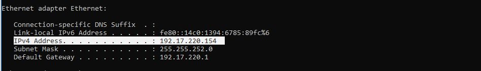

You can see that my server IP is correct and that I made sure that the client IP was not allocated in my network:
 Take note that my network is isolated and in that sense I don't connect the ethernet switch to the network of the building. No router device is available for dynamic IP allocation but based on what I read from the BSL-Scripter documentation, the BOOTP protocol is implemented in the scripter itself.

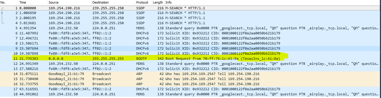

  • Hello Sai,
    This is the wireshark log I got:
    You can notice that after the scripter receives the BOOTP request, the TI device is not sending a TFTP package back.Why is the Scripter registering a TFTP package then?
    I also disconnected other devices in the network to make sure that is not an issue, but the problem persists.
    - Oscar
  • Hello Oscar,
    I apologize for not replying earlier. I was able to replicate your issue.
    As your wireshark log shows, the BSL scripter is not responding to a BOOTP request. The BSL scripter should respond with the client IP address. After that the TFTP transaction takes place.
